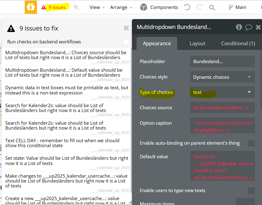

Maybe it is the multidropdown’s Type of choice:
But if I change it to “text”, i’ll get this:
:frowning:
