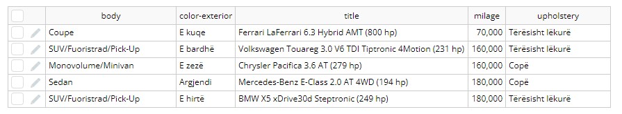

This is my database.
When I want to search by Body (which is not a list because a vehicle does have only one body) with Multidropdown it should be filtered. But I guess that intersect with works only with Lists, and I have a List and an Item.
Or am I missing something?
Thanks again
Fabian

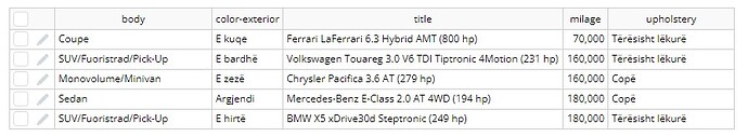

b5
It works… With option Set
b5
That shows that your Body field is a ‘text’ - which is not a great idea (in my view)… so I’d change that if I were you (but if it works, it works - it will just make things more complicated than they need to be, as you’ve already experienced).
You must have missed my question about the field type of the body field. It’s a text field, but it really should be linked to the option set.
