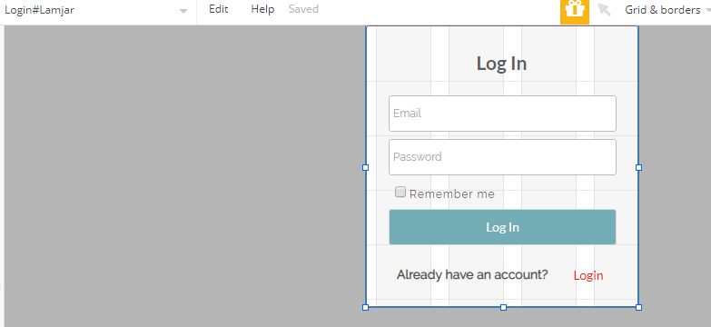

I made the following changes and created a new page for every change so your work doesn’t get compromised. Check below images:
1
I gave reusable element header a border when scroll is above > 5px, I usually use shadow but you have boxed content so that’s not a great idea.
Login popup needs more padding on top and I did that, see if you like it better.
on the third image I made some changes to GROUP POST A JOB, so you can see how you can solve the issue, I think you can better make one big section and not having different sections because the tabbing will not work properly on the entire form. The tabbing works good on the first section :wink:
