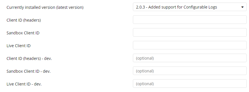

On the plugin configuration page, I have the following:
Now, I have no idea what “Client ID (headers)” require.

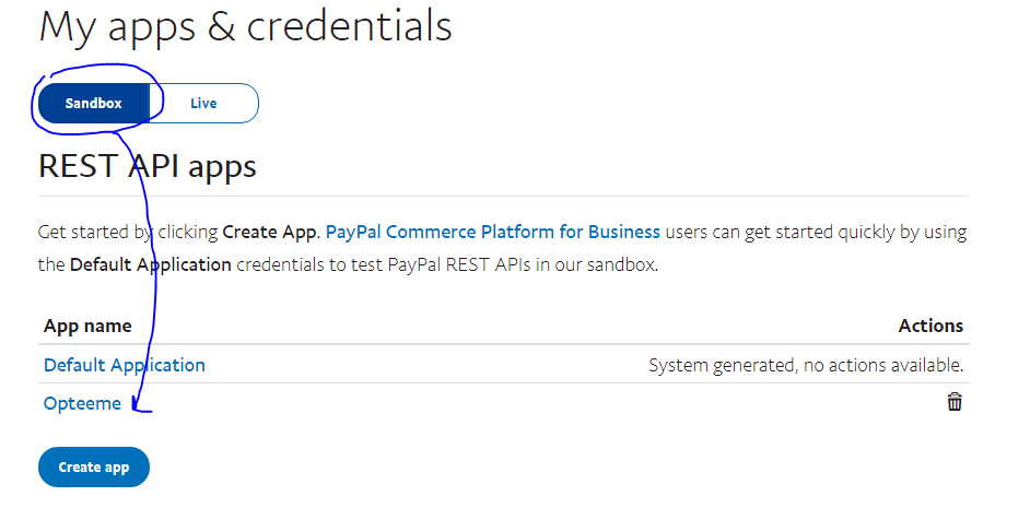

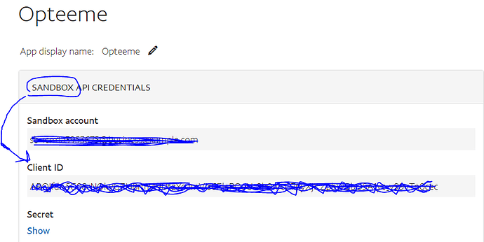

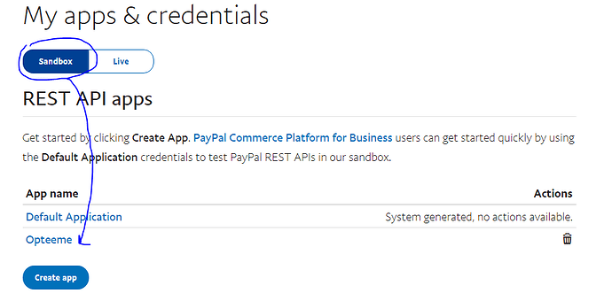

For Sandbox Client ID, I’ve selected
And for Live Client ID
Also I have no idea if there’s any usage to the secret key, or what I should put in the “Client ID - dev” part.

In the plugin settings:
-Client ID (Headers): Put your live client id here
-Sandbox Client Id: Put your Sandbox client id here
-Live Client ID: Put your live client id here
-Client ID (Headers) - dev: Put your Sandbox client id here
-Sandbox client Id - dev: Leave this blank
-Live Client ID - dev: Leave this blank
If you need to charge in a different currency than USD and are getting issues, append “&currency=ABC” (where ABC is the currency code) to the Client ID (Headers) and Client ID (Headers) - dev Ids. This will cause the script to grab the sdk in the correct currency code.
If you get a user doesn’t exist error when testing in sandbox, its because PayPal requires you to make special sandbox accounts for sanbox testing. Real accounts won’t be recognized here. Check your PayPal developer dashboard, there should be a section for sandbox accounts.
