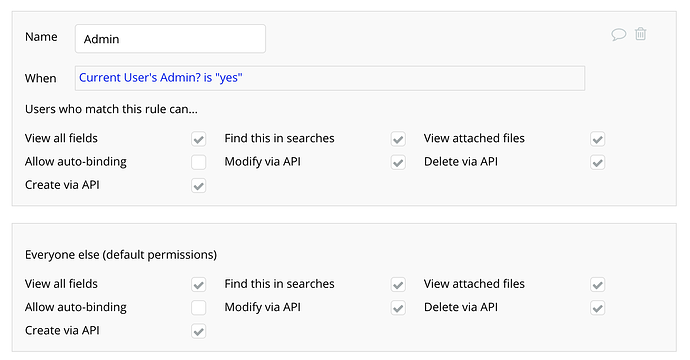

@jcalvarezjr, I finally got it to work today.
I struggled for a while because I had not realised that a data type without any privacy rule doesn’t allow data creation via API. It is actually mandatory to create privacy rules (even if allowing everything for all roles) in order to tick the checkbox “Create via API”.
Does this help? Otherwise happy to share the complete setup, but I think you are stuck at the same point I was.
