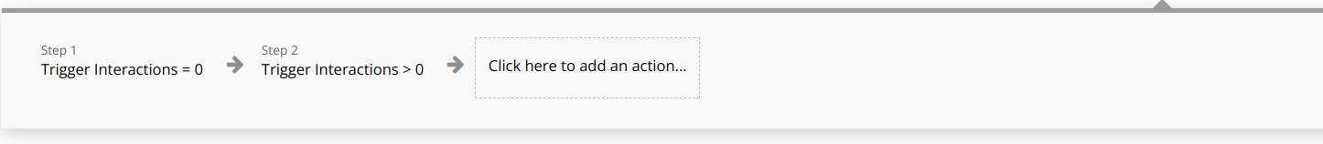

@code-escapee, here is the screenshot of the workflows of interest (note that below I use distinct from the original post numeration of the workflows):
The first workflow (with count > 0) contains
So, as you can see, making changes to the Interaction and creating a new Conversation are the first and the second steps of the first workflow.
Then I run the app in the step-by-step debug mode. At some point I come across a moment of analysing of which workflow should be launched (it seems none of the workflows have been launched up to this moment, since no changes have been made to the database). The first workflow analysed is the second workflow listed above (with count = 0):
and it isn’t started correctly, since we have Interactions > 0 (and the condition is correctly red). BUT right after clicking on “Run next” in the debugger, it seems like both the steps from the first workflow (with count > 0) have already been applied! I make this conclusion because the evaluation of the expression in the condition shows no Interactions (empty result):

So, when I proceeded in the debugger, it showed that the “Interactions > 0” custom event was triggered but it also showed that its condition was not satisfied (it’s red and the evaluation shows empty results):
So, again, it looks like the workflow has already been finished (actually) even before it was started (according to the debugger), and the debugger simply follows the “correct” workflow after all the changes have been applied.
