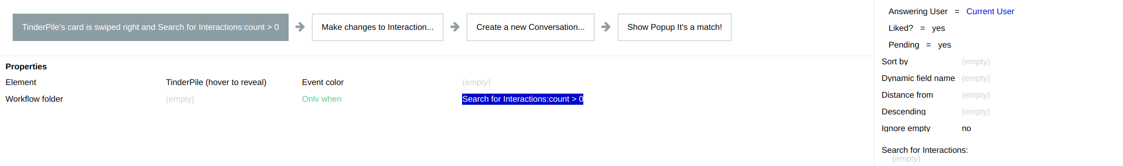

I have two workflows that are triggered under certain conditions. If the number of interactions of a certain type is 0, then the first workflow is triggered, otherwise the second. The second workflow 1) applies a change to the found interaction, 2) creates a new thing of type ‘Conversation’, 3) shows a popup. Here we can see that the first workflow is not triggered (at least one interaction of the desired type was found) and that the app database doesn’t have any ‘Conversations’:

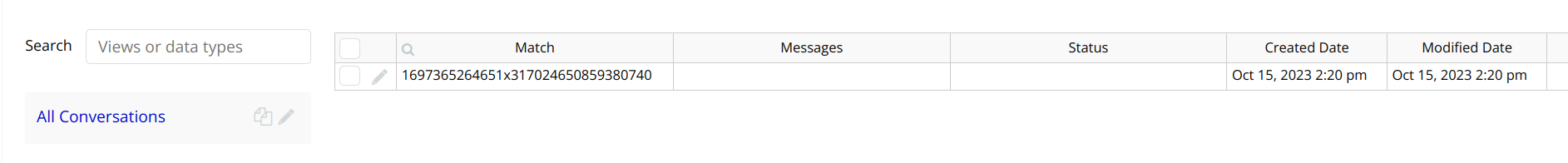

Then I just click “Run next” and right after that it looks like the second workflow has already been applied because the debugger doesn’t show any desired interactions (even though the workflow condition is green!) and a conversation has been created as you can see in the database:
Although the final state is correct, it’s not so in the intermediate steps. And I’m concerned that this can lead to further problems in the feature. So is there a bug or what?

Can you share screenshots of the workflows and clarify what the workflow triggers are (distinct from their conditions)?
A screenshot would definitely help. One thing to check, are you checking that condition at the top workflow level or are you doing that in step one? Might need to do the condition at the top workflow. :blush:
