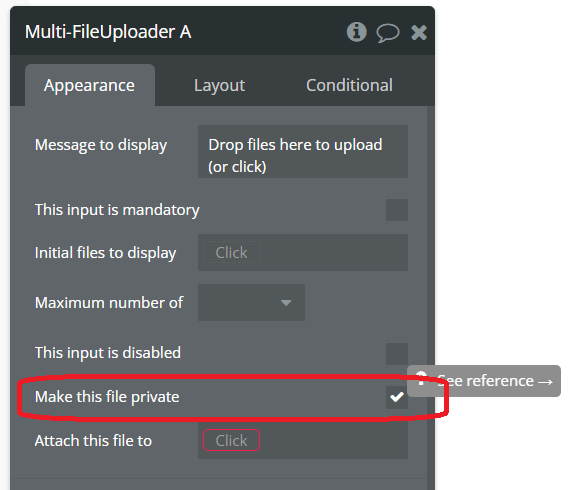

In most situation you want files to be private since that prevents unauthorized users/people from accessing them. However, the single and multi file uploader only make files private if you configure them to do that. By default making files private is not active and if it is, simply deactivate it by unmarking “Make this file private”:

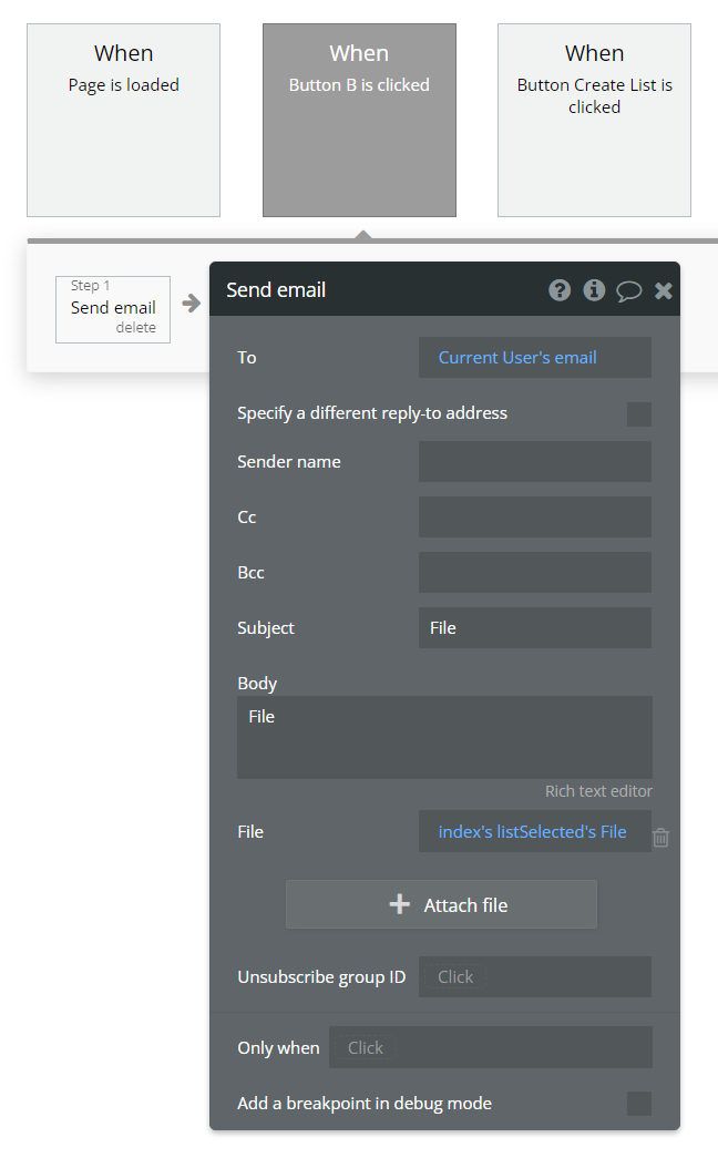

Bubble’s standard send email action has the option to attach a file (see image below), you dont need to do anything with base64 encoding.

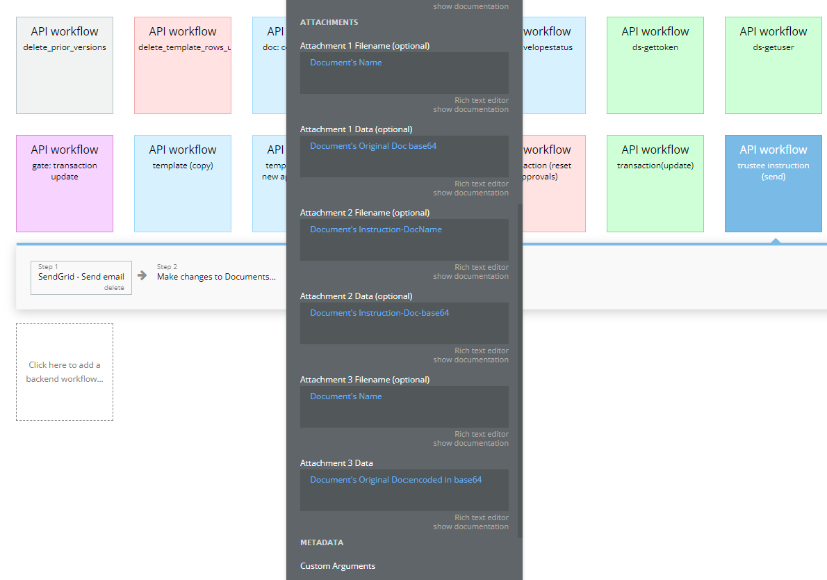

HI @gerbertdelangen
Thanks for all the info. We’re looking to send via Sendgrid (using CoPilot plugin).
We have got the private files sorted, and we are storing the base64 code in the DB at the time of upload.
Maybe it is simpler than I think and we just need to somehow combine the file URL and teh base64 code in the file field when sending the email. Is this correct or is there something that needs to happen at the point of uploading the file.

  1. The settings for the file uploader:

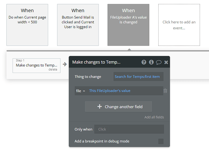

  1. To be able to access the file in the workflow in the datatype temp I have added a field file (type file):
  1. After uploading the file, the file (or link) is added to a row in table temp:

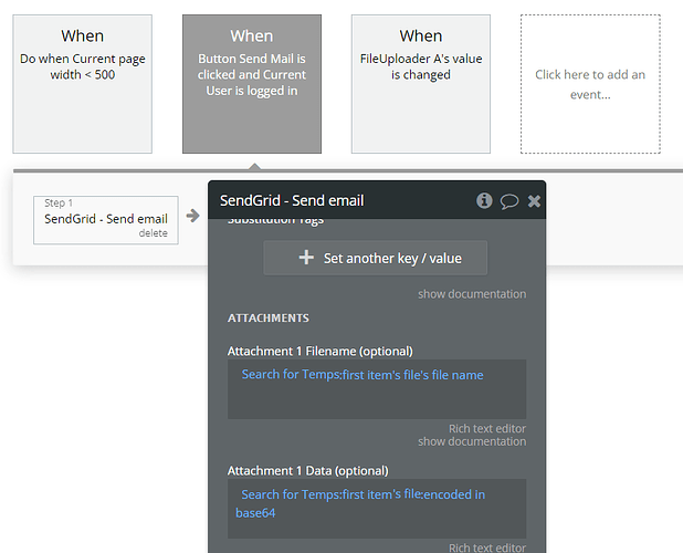

  1. The Copilot Send email action is configured like this:

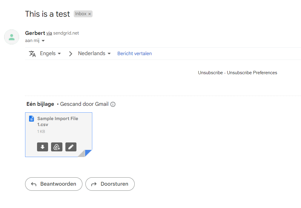

  1. The resulting email:

Hi Gerbert,
Thanks, my email is still coming across unformatted.
I have attached the file as ‘file - encoded in base64’ AND also I have first converted the file to base64 using a plugin and have tried to attach that data as the file. Both to the same result.
See attached screenshot of the workflow and the receipt email.
Any help appreciated.

That is unfortunate. Then we need to rule out some things. Often times it is the privacy rules that cause the issue (actually the improper use of privacy rules :slight_smile: ). Do you mind to turn of the option “Make file private” in the uploader element, upload a new file (important) and try to attach it to the email like I showed you? Maybe even create a new workflow for the time being (to rule out some under the hood Bubble bug).
Hi Gerbet,
Thanks for the continued assistance here.
I’ve turned off private files and re uploaded a new doc and re sent - same issue unfortunately.
