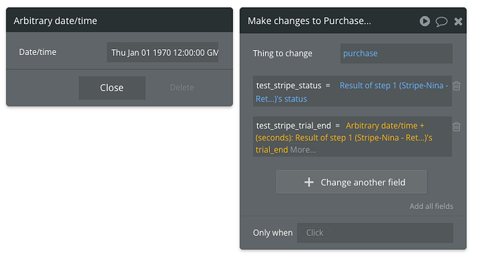

Is this something I could do in one step to change a field considering I get a Unix timestamp? How would that look like?
Thanks!
Screenshot 2023-06-27 at 15.31.25
If the result of step 1’a trial end is a Unix timestamp, then yes, of course…
Just set the value of test_stripe_trial-end to 1st Jan 1970 plus seconds (the value of the timestamp)
I seem unable to enter such “formula” in that field… :roll_eyes:
I think I got it!
That looks right to me… does it work as expected?
It somehow adds 11 hours with this time set.: Thu Jan 01 1970 01:00:00 GMT+0100 (Central European Standard Time)
I cannot set to 00:00:00
In you screenshot you’re setting the time to 12:00 midday (instead of 00:00)…
You should be able to set it to 00:00
Actually it’s set to Thu Jan 01 1970 01:00:00 GMT+0100 (Central European Standard Time)
And everytime I set to 00:00 it switches back to 01:00. I still don’t get the 11 hours difference.
Got it.
I had to copy/paste it from an external text editor. :crazy_face:
