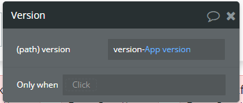

Hey @pieter and @lmourasse,
Be sure you’re on the latest version of the plugin and are setting the Version field. :slight_smile:
@pieter This is how it looks after downloading the latest version. Putting it out there if others face the same problem one day:
Instead of writing separate workflows for test and live versions, you can use bubbles “App version” option, “version-App version”. See screenshot below.
