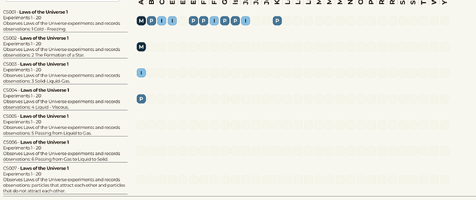

The standards, students, and their progress are in three different databases. The ‘grid’ is really 30 inactive buttons with the letter code for the student’s progress. So each row in the repeating group consists of the standard (about 4 rows of text) and 30 boxes. The boxes are filled out by search the standard’s ID code and the student’s (in that column) unique ID in the Progress Database. This is done for each student in the top (separate) repeating group of students in this classroom.
Example: The first row, first icon is a dark blue M. This means they have mastered that standard. The “code” to fill the box is:
Search for Student Progress where:
-----lesson code = Parent Group’s Standards’s ID
-----student ID = Search for Students:first item where:
-----------unique id = RepeatingGroup Student’s List of students item#1’s unique ID (where 1 is the column from the student names RG)
I tried NOT searching for the student’s ID using the RG of students, but could not get the types to match (must be a Student not just text).
I hope that made sense.
3 Different data types in the one bubble database.

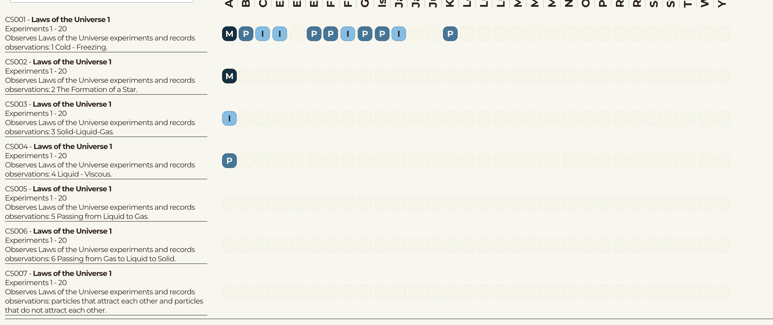

So for every single box that might exist (30) you are performing a search in it one each row in the RG which is done for each standard (2000) for each student (250).
I’m not sure what that screen shot shows because the CSOO1 or CS002 is that what is called a ‘standard’ and sho that screen shot is showing me a repeating group with 2,000 standards that are needing to search on 30 different icons for each of the 250 students? If so, which it sounds like it, you are performing 1 search for each icon, for each standard for each student…so I could just be misunderstanding the setup but you are definitely doing too many searches.
Using legacy bubble database structuring I do not see a way to remove the need to search as much as you are. Maybe somebody else would have some more insight into how to reconfigure the data structure using legacy approaches, but based on how I understand this at the moment, I do not see an obvious fix to the issue.
But if I were building this for a client, my standards would be api objects and I’d use my plugin Data Jedi to make all things necessary simpler. This would allow me to have all the 2,000 standards downloaded to client device for 95% less WUs than legacy approach with custom data type. I would also have all Lesson codes as API objects as well since in a Hybrid Data Structuring approach those are basically options to choose from. I would also have a student progress data as an api object so that when a student takes a lesson, I save all details to that object. Then all that is left to do is just reference each data value that is already on the device using the IDs of each thing…this would reduce the WUs by 95%.
