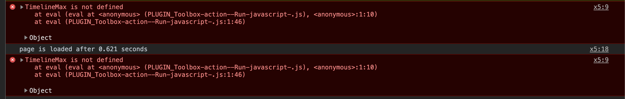

I get ‘TimelineMax not defined’ although I have tried importing jquery in my headers and everything.

Unfortunately because it has javascript and uses jquery, I’m having trouble. I am trying to load the latest jquery but it says its already loaded. And from what I’m finding, the TimelineMax() function is not being found.

I tried using ToolBox plugin to put javascript in the page but I get that TimelineMax() error.

if I do this:
I get this error
if I remove the jquery load
I get this error
which if you inspect the code you find the console says:
So there you have it!
No, I don’t know what to do to fix it but I know someone on here has some insights. :slight_smile:
TIL all this stuff requires https://greensock.com/ . (GSAP) which is a javascript animation library.
