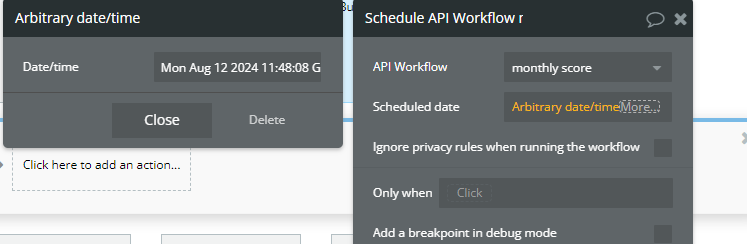

@stephane_hildbrand I tried arbitrary date, and it gives me that mid month result again ,I am not sure if there is something else i should type to set it to be 1st day of the next month?
Given this screenshot, it seems you’ve manually chosen to initiate the first iteration on August the 12, you need to choose august 1st there.
Got it! I see what happened, I used arbitrary date and typed " first day of next month" it resolved it to 12th Aug and I concluded that was it. However your suggestion made me do the simple change of going in and now editing the 12 to 1 and here we have an accepted entry of 1st Aug. Thank you so much @stephane_hildbrand you have indeed made my friday and I appreciate you very much.
