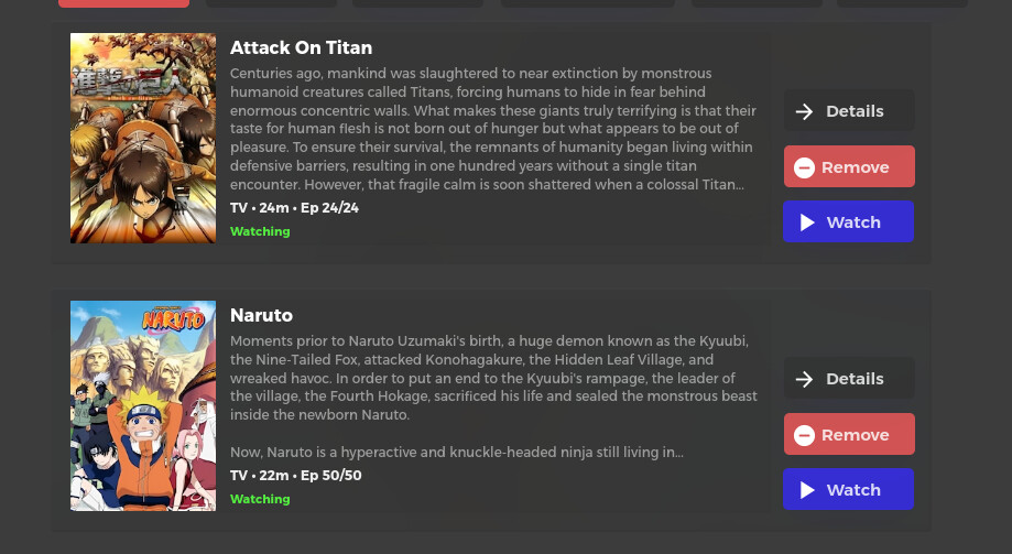

This didnt quite work.
When I try to add another series to the list with a different status, the other series has the same status as the one I just added.
The “Attack On Titan” series was intended to be on hold and the “Naruto” series was to be on watching, but it was changed to the same status as the one I just added which was naruto.

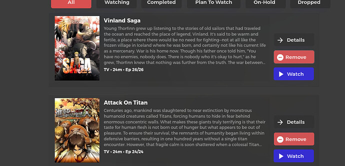

Now the text is not showing
How about you sign up for an account on the website and try it out for yourself in debug mode?
Once you sign up press “Watch now” and press “Add to list” on at least 2 series then look at your watch list.

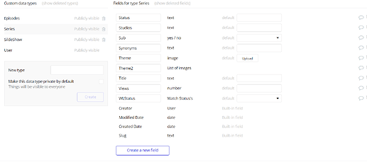

You seem to be doing the right thing in your conditions for the watch status.

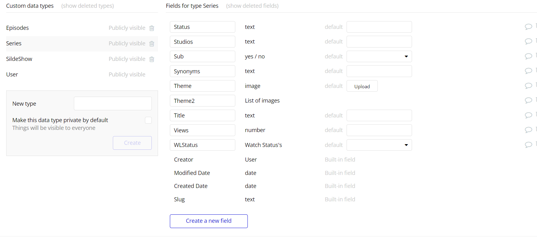

The reason why the series’ watch status are all the same is because you structured your database that way. The series’ status is not dynamic for each user.
A user might be able to add a series to their list of series but you won’t be able to change the specific watch status for each series.
If you change a series’ status to say, “watching”, all users that has that series on their list will also see “watching”.
To solve this, you need to remove the field watch status in the data type series
To make the series’ status dynamic to each user, you could instead make new list fields for your user. One per each watch status.

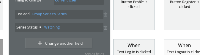

If user clicks “add to watch list” You could simply add that series to user’s watching list
There are a lot of nuances on how to implement this but the best thing that you could do right now is to optimize your database structure
