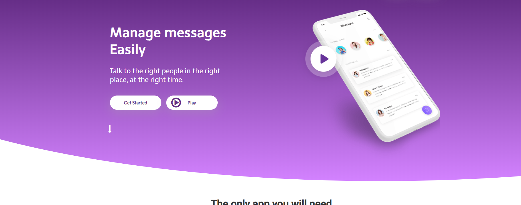

Just after some advice on layout of an element. I have gone through the templates and came across the ezstarter pack, this looks really good and i am trying to learn how some of the elements are put together and how it was made.
One of the things i really like is the banner element that has a curve going along the bottom. For the life in me though i can’t work out how this is achieved. The element doesn’t have any shape to do this and i can’t see anything in the workflow.
How would you go about doing something like this?
image below of what i am wanting to do.
Any help really appreciated

Found the solution for this.
in case anyone else wanting the desired effect or to know how then you need to add some HTML to the page/element.
Firstly go to settings>General and tick expose the option to add an ID attribute to HTML elements.
Once done add the html to your page, then for your element add a tag to the ID attribute
For the above i basically have a Group, i added the ID banner_bg to the ID attribute. Then add the html to the page along with this code (put style tags at start and end)
Blockquote
#banner_bg{
height: 100vh;
-webkit-clip-path: ellipse(100% 80% at 65% 20%);
clip-path; ellipse(100% 80% at 70% 20%)
