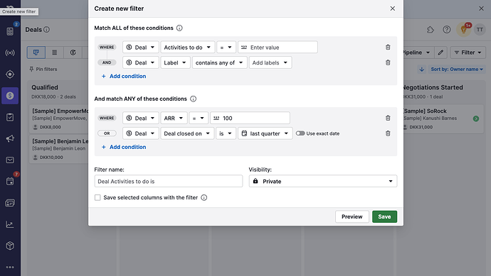

I need to create custom filtering like in Pipedrive. Some fields for the criteria are fixed (DB fields) and some fields are dynamic/custom. The search comparison are all “dynamic”; user can change the comparison for each criteria. Has anyone done something this complex in Bubble? If so, I would appreciate some tips or best practices. :folded_hands:
Added:
A filter consists 1 or 2 set of criterions: 1 for AND and 1 for OR. Each criterion consists a field (fixed/custom), comparison operator, and a value.
