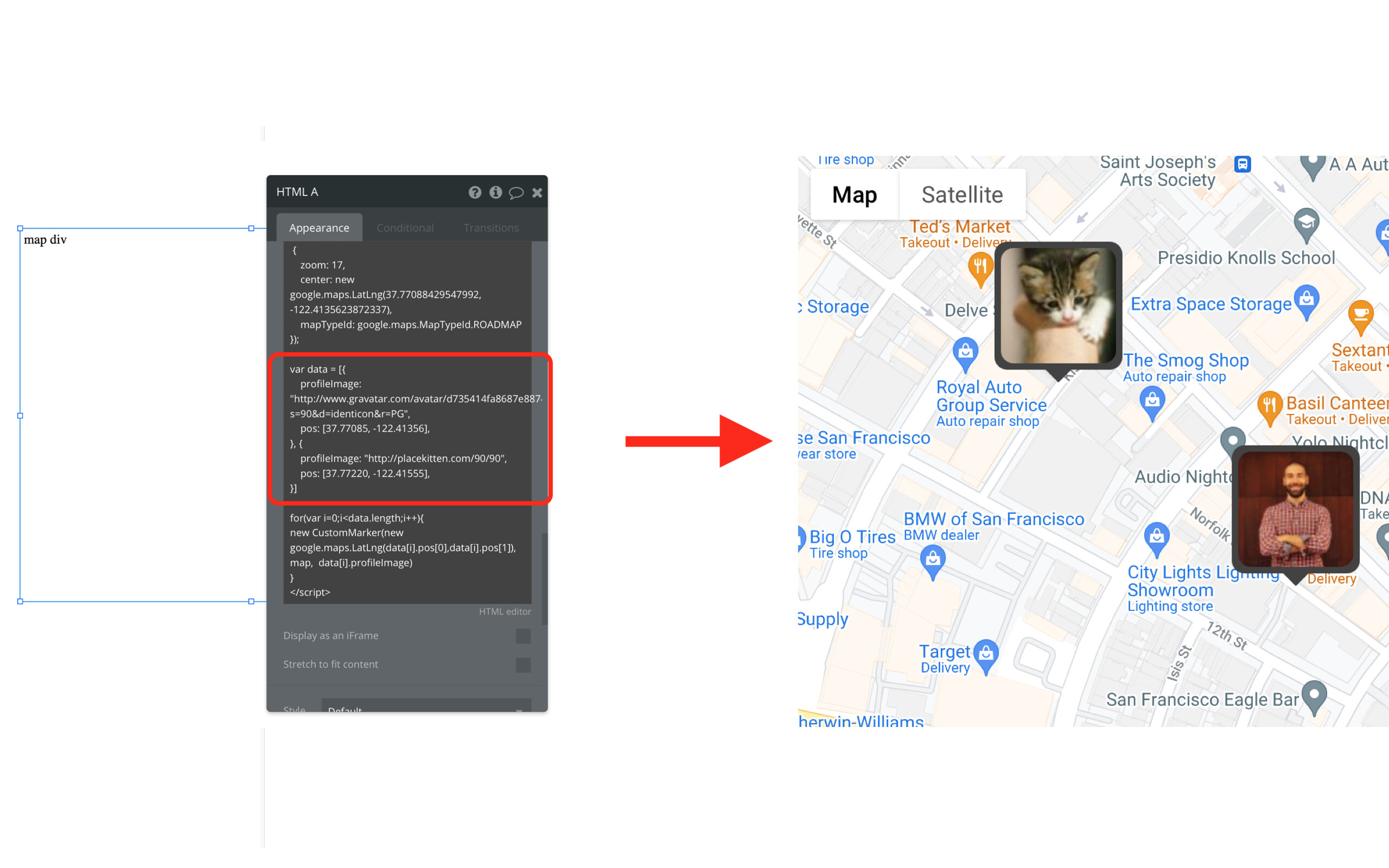

After having follow this solution Custom map marker , I succeed to build a map with custom marker here is the editor Flex2 | Bubble Editor.
This particular code in the red box display “cat marker” and “man marker”.

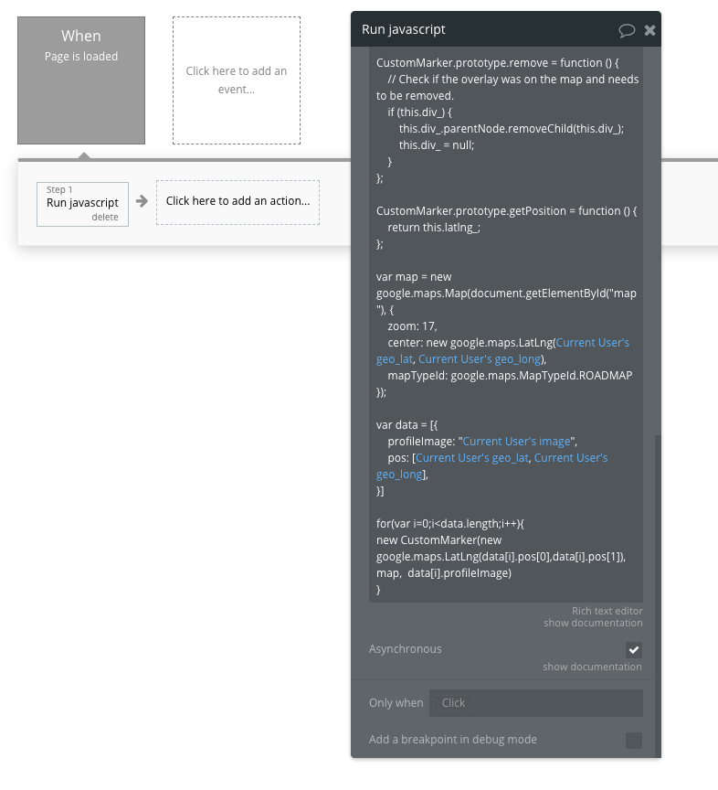

Now I’m searching a way to integrate bubbles expressions " do a search for user’s profil" , “do a search for user’s geo lat” , “do a search for user’s geo long” to add automatically all user’s marker of my database.
Here is the 3 bubbles expression that I want to add in this javascript code.
This code on last picture doesn’t work. It s just for exemple.

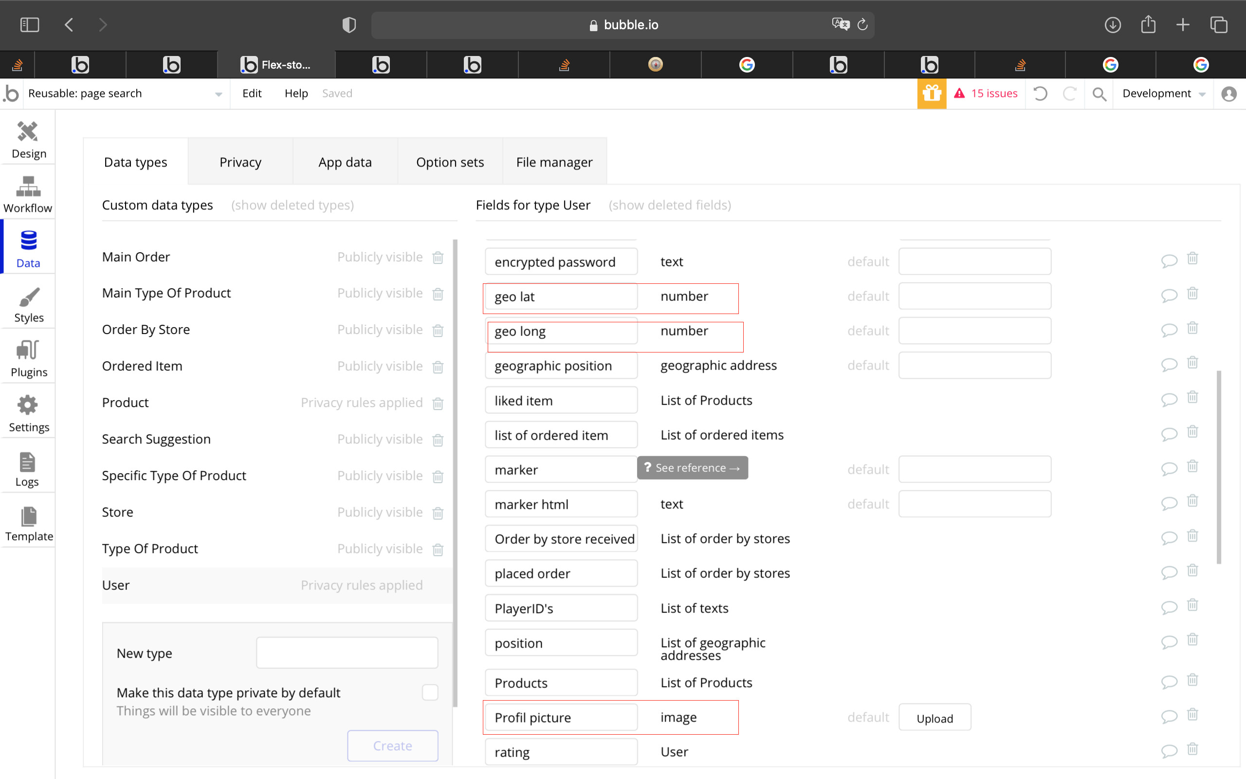

Here is screenshoot of list of data in the database that i want to use in javascript code.
-do a search for user geo lat
-do a seach fo user geo lon
-do a search for use profile picture
I know where your problem is.

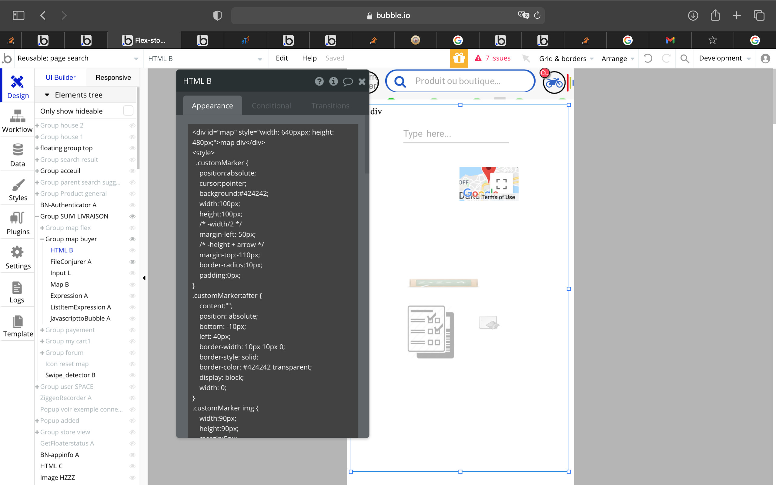

You have the same javascript code both in the HTML element and in the On Page Load workflow. You can delete the <script> ... </script> part in the HTML element, is doing nothing there (you can also leave it if you want, it does no harm). The one that works is the On Page Load.
So that means that the dynamic data must be in the On Page Load workflow, and you now have it in the HTML element.

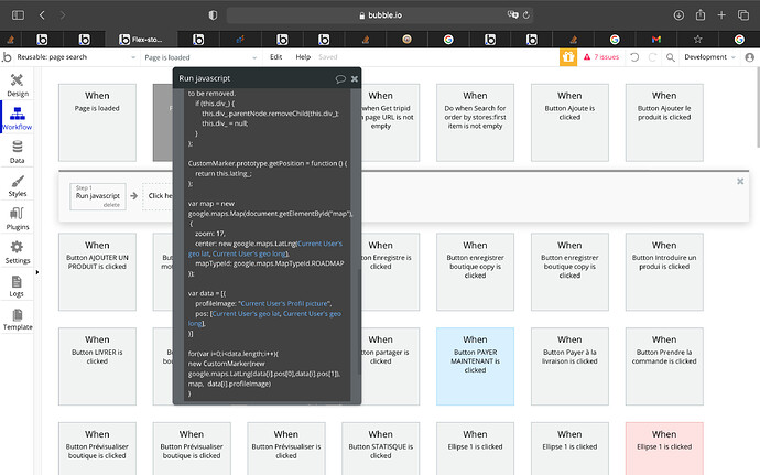

Hello Cristian.
When I run this Javascript code, nothing happens in my map and if I delete the <script> ... </script> part in the HTML element my map disappear.
here is the editor link: Flex-store-sub | Bubble Editor
I don’t know if in Html b and run Javascript action I have the same code as you.

-In the editor, html B and Javascript workflow are in reusable page search
We should have a code with list of latitude, list of longitude and list of profile

What you have in your screen capture is not the same that what you have in your app.
In your app you are trying to put a list of profile pictures, but it doesn’t work that way. In order to do that, you have to schedule an API workflow on a list.
