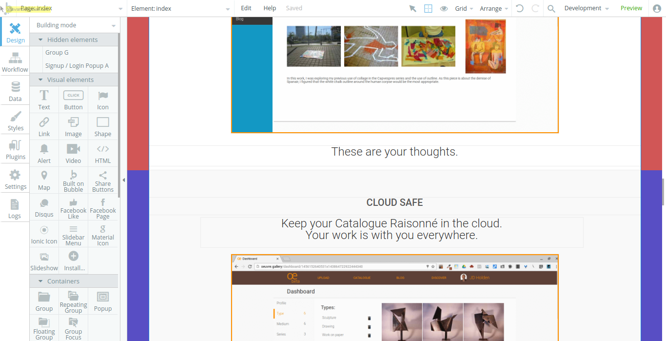

How about this one then… were putting stripes across our home page, and each stripe is the same size as the box it matches. On the Bubble editor you can see it works fine: (we’ve made the stripes red and blue for clarity)
On the Preview, things behave badly…
We have lots of stripes all working fine, expect this one…
