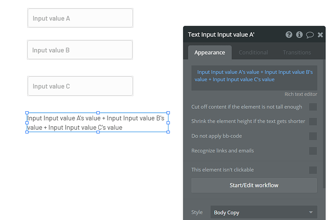

HI,
I would like to create an app that responds to inputs instantly.
E.g. ("a+c-b%=£x)
But i cant seem to find the correct stuff to do it with.
I am new to Bubble so it may be me
Thanks in advance of your help
Steve

Do you mean that you have inputs a, b, c, x and it gives you a calculated value?
This is a basic way to do this without creating anything on the dB and just adding and showing the result in a text element
Yes please, i need them to input, date, Quantity, retail value, department, and will set up a formula for the reduction value that i want to display
Add the necessary input elements, dB data types, logic to add them to the dB, and expressions to display them in the UI
