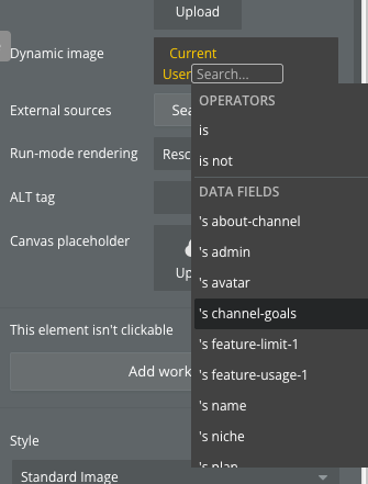

I can select the Current User, but nothing that seems to be getting me to the other data type

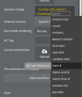

If I start with “Current cell’s Query”, I can maybe get a bit further, but I’m not sure how it all ties back to the authenticated user (image 2).
if I try to test it in the data tab, I don’t seem to be able to get an image into the page
