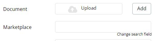

I tried that but for some reason its not inserting the ID of the Marketplace data type into the Marketplace field in the Request datatype
Just to expand I have a field Marketplace in the Request Data type.
I want to be able to pull the data into the dashboard of the inter-related user to manipulate and display some of the fields in the Marketplace data type.

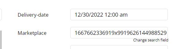

I’ve uploaded screen grabs but still cant see where I’m going wrong.
Thanks for your help.
Maybe I’m missing something…? But from your screenshot it appears to be working correctly?… (unless the screenshot is of something else?)
What exactly is the problem?
The problem is that its not inputting the Marketplace data type into the Request database.
For the current user it works fine i.e. creates a Marketplace datatype and inserts into Marketplace database and also inserts into the marketplace field in Offer database.
My problem is it wont insert into the marketplace field in the Request database.
The current user is the owner of the Marketplace datatype and the Offer datatype - my main issue is that I need to include the inter-related user of the Request datatype.
Request and Offer are originally related at the the start of the process but when I try and link the new thing Martketplace datatype to the Original request is where I’m encountering a problem.
