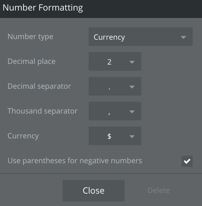

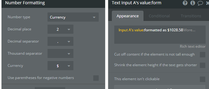

When displaying a number formatted as currency, set the decimal to 2. Your number values in the database won’t show up with trailing zeros, so if you need to display them, you’ll have to format the value with the proper currency setting as shown below.
Same principle applies for percentages… 5% is going to be saved as .05 in the database, but formatting it will allow you to display as “5%”

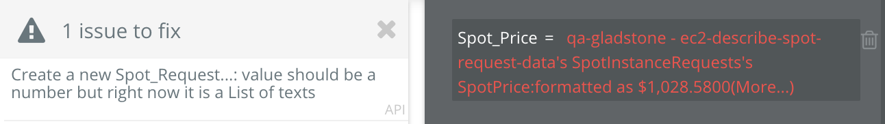

I’m following your instructions but isn’t quite working for me… The only significant difference from the example above is that my number comes trough an API call…

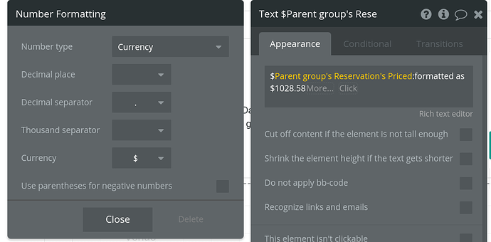

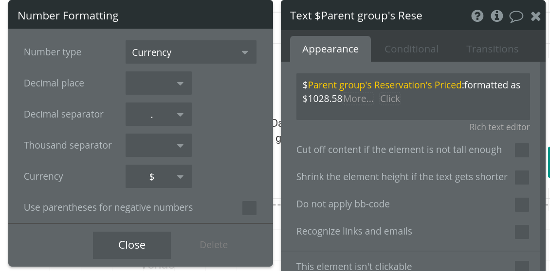

3-Configure “formatted as” like you instructed
4-As I’m setting the relationship between my Data thing and the API call the text is all in red even when I added the “formatted as” option like you did. Bubble gives me the following error:
What you think?
When you’re saving the value to the database, you just want to save the number without formatting. Once you format, you convert it to text, which is why it’s in red (number cannot equal text).
Only format the number when you want to display it on a page (in a text element or input) and leave the raw value as a number in your database.

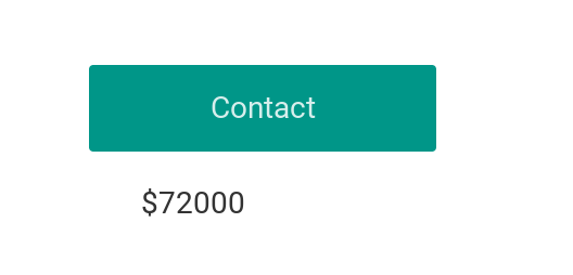

Hi, I’m having the same issue with the numbers not converting properly. I thought I set all of the parameters correctly I am still getting multiple 0’s. In the example with the pictures, I want the value to be $720.00. In the database, the value is 72000. I’m using Stripe as my payment processor, do you think that has anything to do with it? Any help would be greatly appreciated! Thanks!
48%20PM
35%20PM
Stripe API handles amounts in cents, I suggest dividing by 100 when storing in your database.
How would I do that?
Something like
Priced = Result of step 1’s Amount Charged / 100
Don’t forget to multiply by 100 when sending amounts to Stripe’s API.
Thank you so much!
