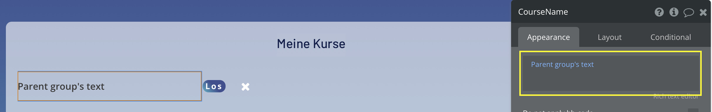

I chose text, as this was the only thing which worked for me. If I change the RG type of content to Courses, this is what I get.
Hi there, @tobias2… stop that expression after Current User's SaveCourses2 (i.e., get rid of :each item's Name). Then, have the text element in the repeating group display the Current cell's Course's Name. Finally, as Adam said, when you are removing a course from a user’s list, simply remove the Current cell's Course.
Best…
Mike
Great, that trick did it. Thanks so much for your quick support @adamhholmes and @mikeloc. It works now after changing type of content to courses.
