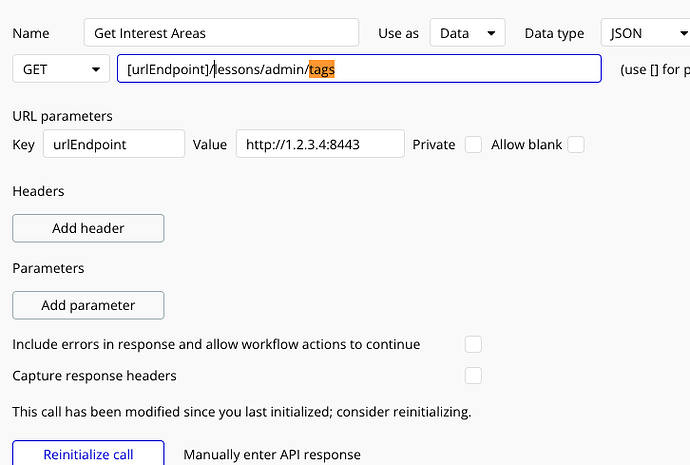

I’ve managed to do this with a single connector where I’m using a param that gets translated to an endpoint (via an option). but the problem is having do to this for every call and every endpoint! Lots of room for errors.
I feel like even having a “base URL” type thing for APIs would solve half he issue, so that at least I don’t have to maintain this paremeter on a call-by-call basis, but sadly that’s not a thing in bubble.

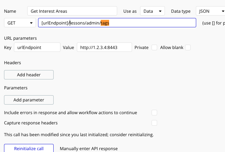

This the setup that I currently have.
I then have the following option set setup:

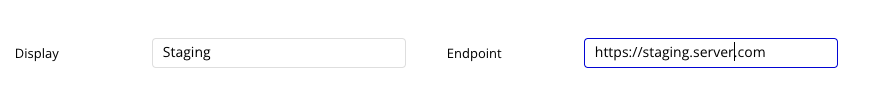

An example of one of the options is as follows:
And finally, when I’m making the call from the page. I pass urlEndpoint param by converting Isn't live version to one of the option sets
As I have mentioned before. This makes setting up the endpoints and then calling them more tideous than needs to be. And the more things I have to maintain the more room there is for effing something up.

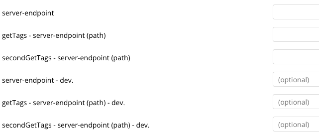

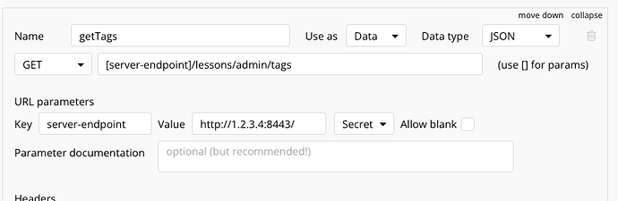

I worked out that I can see individual API endpoints’ params marked as Secret in the plugin configuration, which is definitely a step in the right direction, but unfortunately those aren’t shared between the calls, so I would have to duplicate the same value for each endpoint
Setup
Configuration
If I could somehow reference the shared server-endpoint parameter that would be great.

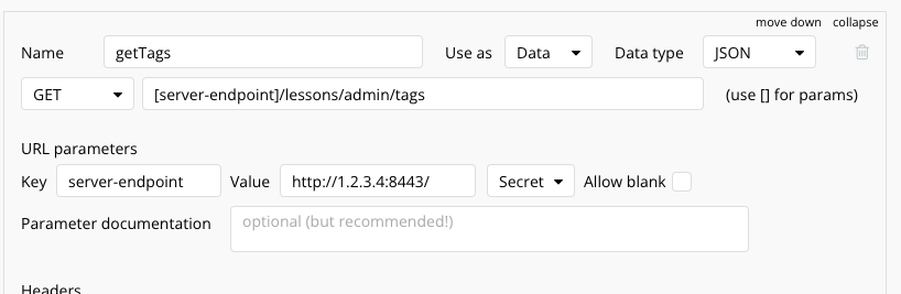

Alternatively I’ve tried setting up these calls as Actions of the plugin, but the problem I run into there is being unable to define complex return types as I’m limited to the following options

This would have worked perfectly if you could define a shared prefix for all calls of a given API, but right now, simply using the same name, gives you an input box for each call in the plugin configuration. Check out my previous post
