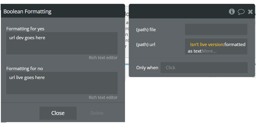

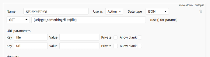

Well, it sucks maybe a bit, if you set up your API calls like this you dont need to create seperate calls for Live and Dev:
In the action use a condition to determine the URL:
For the Header you can do pretty much the same, additionally save it encrypted and external for extra security.
