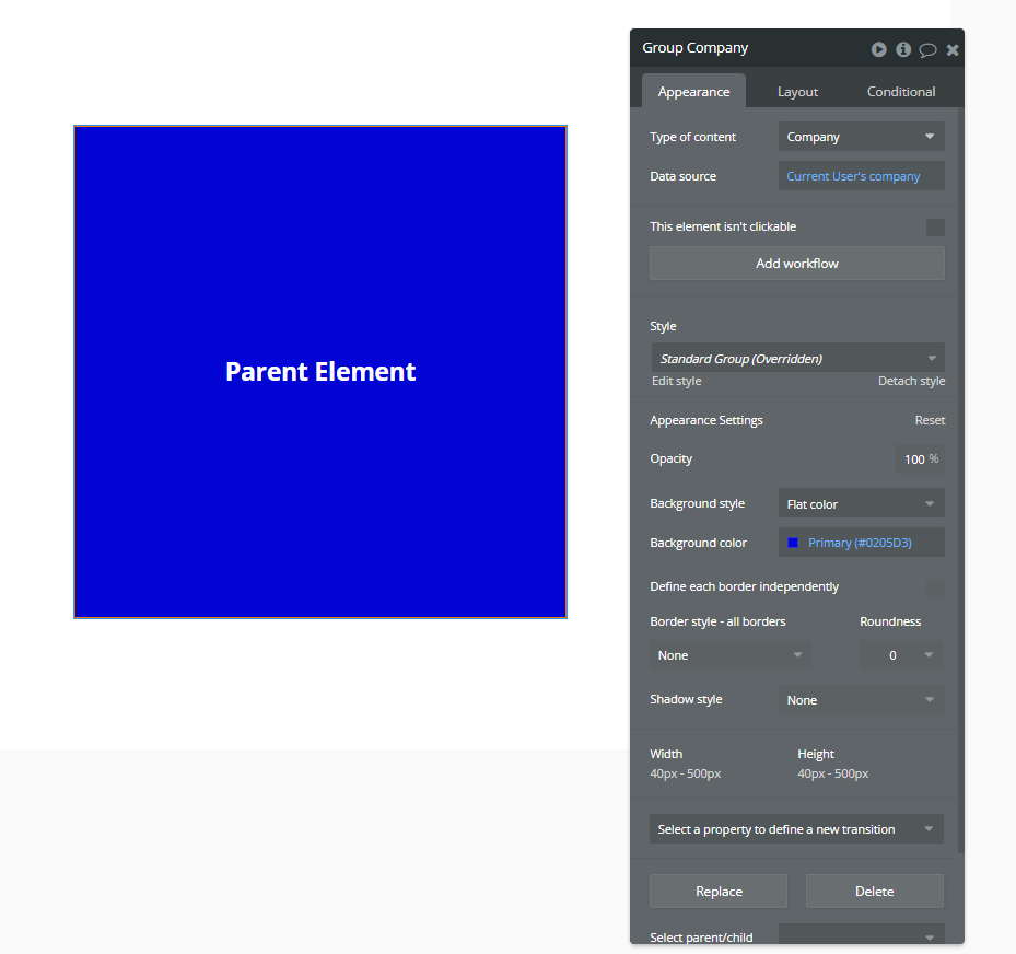

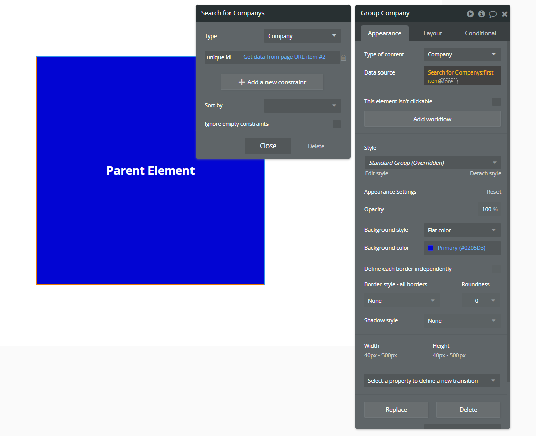

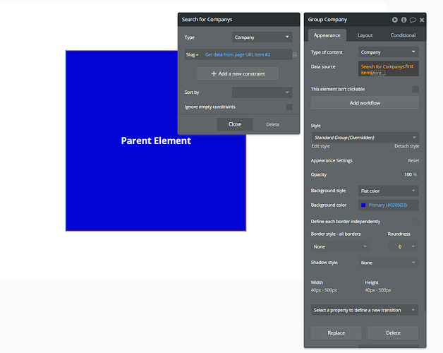

There are a couple of ways you could do this. You could:
  1. Send the company data to the page using url parameters or path segments and having the parent element search for a company with the value of the url param as a constraint
  2. Have the page/parent element to reference to the user’s company by either searching for the company or referencing to a specific company record in a field
Overall, it would depend on your data structure and if you want to use url paths (website.com/dashboard/companyUID).
Here’s a few examples of how you might do it depending on your DB structure
Hope this helps!

What I outlined above are examples on how you might structure it. It would still depend on your data structure or how you reference to the company in the url e.g. url parameters, paths, etc
