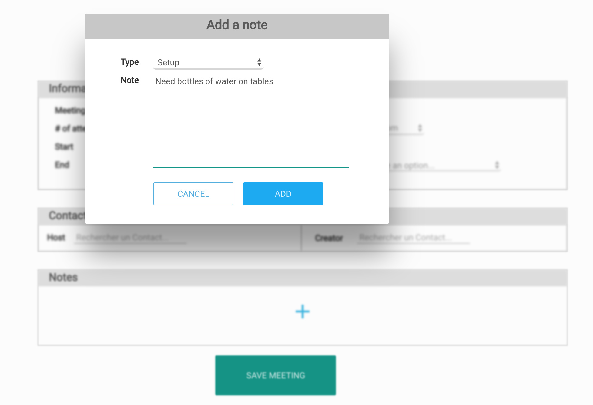

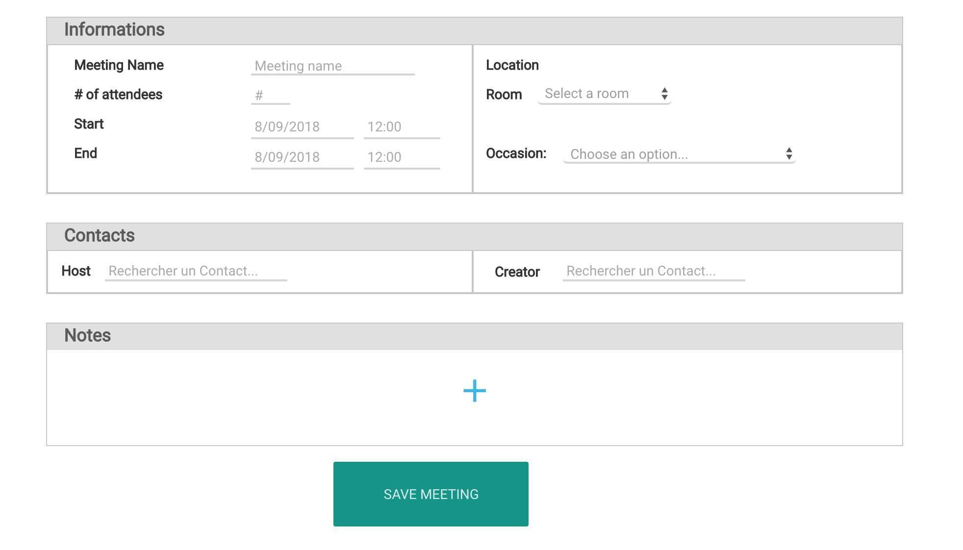

I’m trying to create a meeting page, where you can enter name of meeting, # of attendees etc and then save that meeting in the database. So far, so good.
However, I would like to add a “notes” section to the page, where the user can add different notes about the meeting. For that, a popup is displayed when clicking a plus sign asking the type of note and the note the user wants to input.
But I don’t understand how to display this note from the popup to the “notes” repeating group without creating a thing.
Maybe I’m missing something, but my idea was that I shouldn’t have a NOTE thing in my database and add those notes to the database and then display the data in a repeating group because I can’t link these notes to with the user (and I plan on having multiple users using that page). But again I feel like I might be missing something there.

@smonbrun - Can you clarify a couple of questions please?
  1. From the notes popup I see there is a note type so I’m assuming that there can be multiple notes created and therein lies your problem … the value of the Notes Input Element is overwritten by the next note so when you come t save you have only the last value.
  2. You want notes to be associated with a User and with Meeting so the notes are only available when that meeting is being viewed and only by the user that created them.
That makes sense. Thanks for the input @stolzj19 :+1:
Hi @patricia,
  1. Yes that’s indeed one of the things I don’t understand how to fix. I need the RG to display all the notes created by the user on that page and for that event.
  2. Exactly.
@smonbrun given that you have multiple notes, each with a type and content, I can’t think of any easy way to save them as temporary variables.
I think you are going to have to save them to a Notes db table and use a unique ID you create (e.g. next number in a sequence). You could save the type, content, User ID, your unique ID and just leave the Meeting ID blank for now. Then when you come to save the meeting you would also have to Make Changes to a list of Things and add the Meeting’s ID to the already saved notes. If the user decided not to save the meeting then you would have to run a workflow on a list of thing to delete the notes that were saved. Is this making any sense?
