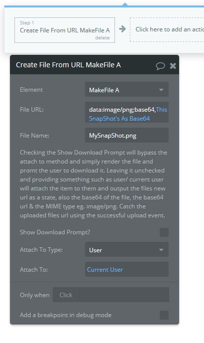

The Documental Plugin now gives Documental Subscribers the ability to save files from URL’s to the database or from URL to download prompt for a user. This is great to combine with the SnapShot element and it makes all your Documental conversions savable to you own database. The best part is your file’s URL will then be under your apps domain!
Drop both the SnapShot and Make File elements on the page.
Grabbing the SnapShot’s base,
1
Then this triggers,
2
Run the element action,

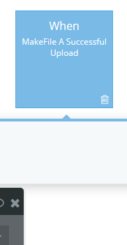

When its ready this event triggers,
5
Save it to your database,
6
if you want the download prompt instead of saving just check the show download prompt,

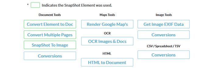

In the demo the first button labeled ā€œConvert Element to Docā€ wrapped in the green boarder (Indicates the SnapShot Element was used), shows the method and result of an element becoming an image, then the next shows a multiple page example, again using the SnapShot element & finally the SnapShot to image shows a single page to image action.
The question relating the the HTML action, how its used & how it would look, the demo for this is labeled ā€œHTML to Documentā€ & is shown visually in the live version (both the code that is sent & the document that’s returned). The workflow for this particular action contains only 3 actions and can even be shortened from here.
