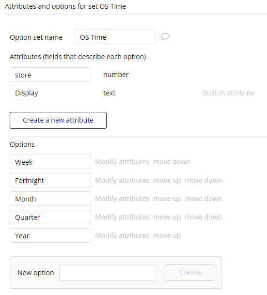

Hi there, @neilgellett… I would use an option set to do what you have described, and I would configure the set with the display of each option being Week, Fortnight, Month, Quarter, and Year. Then, I would add an attribute (with a type of number) to the set, and I would hold the numeric value for each option in the attribute.
Options:

Finally, when you save the dropdown selection to the database, save the option’s attribute into a number field, and you’re all set.
