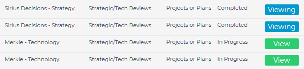

  2. I notice that when using the live app, when I make changes to records, bubble is creating duplicates of the record, which show up in my repeating groups (see screenshot). However when I look at the underlying data, there in fact is only one single record. Seems like bubble is getting confused. Is it perhaps looking at both the regular table as well as these “(modified)” tables? Is this some kind of bug?

The displayed duplicates show up even after I clear the browser history and do a complete refresh. It doesn’t happen with every record, but it’s happening occasionally when I add a net new record or make changes to an existing record. In the case of the screenshot provided, I had made changes to existing records. Regardless of browser or computer, these keep getting duplicated. It’s really weird.
I’d take a look at your workflows. Depending on how you have it set up, you might actually be accidentally creating duplicate records. Can you share a link to your editor so folks can look at it?
Upon further investigation, that’s sort of what was happening. Essentially an update to a child’s parent reference first needed to remove the previous/old parent reference. Because this wasn’t being done explicitly I was ending up with a child being related to two parents and therefor bubble showing two identical children in my repeating group. Now that I’ve added an extra step in my workflow to first remove the old parent/child relationship before creating the new one, the problem is fixed. Thanks to @andrewgassen and @romanmg for your help!
