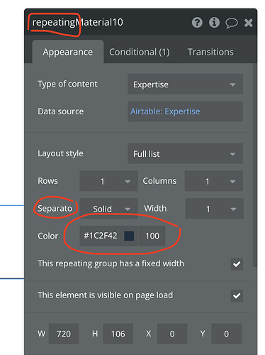

I’m working with a repeating group and would like the separator to use dynamic colors. As far as I’m concerned, this is not supported currently. See attached image. I’m trying to implement a dark / light mode using an option set … What’s a good workaround?
Many thanks for any help or hints!!

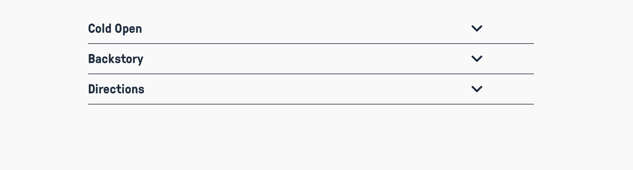

Thank you for your quick reply! I have additional groups above and below the repeating group. Like so …
– group A
– - repeating group
– – - group B
I use the repeating group in conjunction with an accordion menu. See attached image. Using a border color with either group above or below has not the same effect as using the separator. I thought about a conditional statement, but the separator color or any parameters of the separator don’t seem to be accessible via conditionals.

Hey Guys…
I just checked out that there is no such option in my repeating group.
any reason why??
You have a default style set
ohk, i got that in style tab.
thank you @chris.williamson1996 for quick response.
You can click remove style on individual elements
Thank you very much. I believe, there’s a compromise to this solution. It adds an additional line at the top of the list. Unless there’s a way to specify “First item transparent, or something of that sort”. Couldn’t figure that out.
I removed the separator and added a shape (colored red to clarify) at the top of “group B”.
If current cells index = 1 border top = white with transparency 0
Genius. Thanks a lot :slight_smile:
