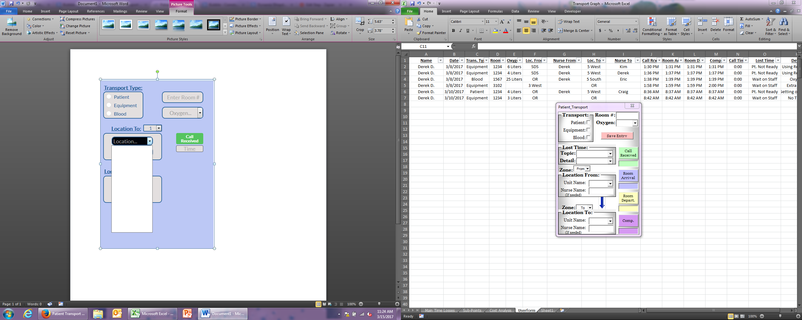

Hello all,
Currently I’m trying to figure out how exactly to get different options to appear in my dropdown box (location), based off of my dropdown box (the 1st zone dropdown). It’s confusing to me because I can’t seem to get to an option that says based off of the zone dropdown I want this in the location options.
Any help would be appreciated.
Thank you.

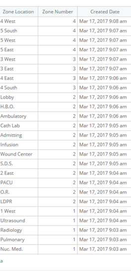

Thank you for your input. From reading a few of the forums I realized that I needed to create a data base (see above). Have I done this correctly? I have 4 zones and each zone has locations underneath it.

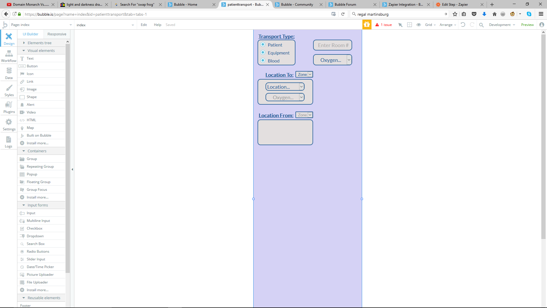

Additionally, the last conditional option I’m using is what is giving me the problem. Am I setting this up correctly as well? I cannot seem to get it to simply look at the list of things in zone 1 so I know I set something up wrong, I just don’t know what it is.

So I want the use to select a zone from the zone drop down:
Let’s say zone 1 is chosen:
I know it appears blank, but I would like it to populate all the zone 1 locations that are in by database because the user chose zone 1 from the zone drop down. So it should display “1 West, Ultrasound, Radiology”… etc.
