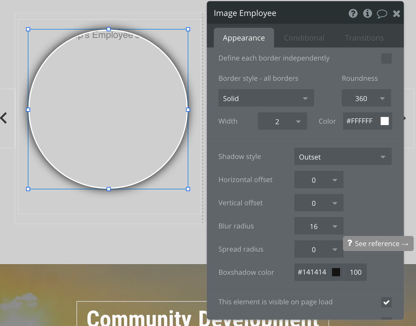

When I have an image that is placed on the page it rescales fine. I have the image as a circle and it shows really well.
Here it is in display:
Here it is in editor:

I understand that it seems like the main reason is that I uploaded a static image which became a link to :
//s3.amazonaws.com/appforest_uf/f1557765165654x714303612590605400/Asian_Female.jpg
This link I believe is a cause of the image in the editor to have the width resized, however when I have this image not as part of a repeating group, I am able to resize the image width to be the correct dimension resulting in the appropriate display.
The problem is when it is part of a repeating group, the image is getting resized and I would obviously be unable to manually resize.
How can we get an image that is in a repeating group, that has a dynamic image reference to the database and is using a rounded design have the image displayed with the preset dimensions?

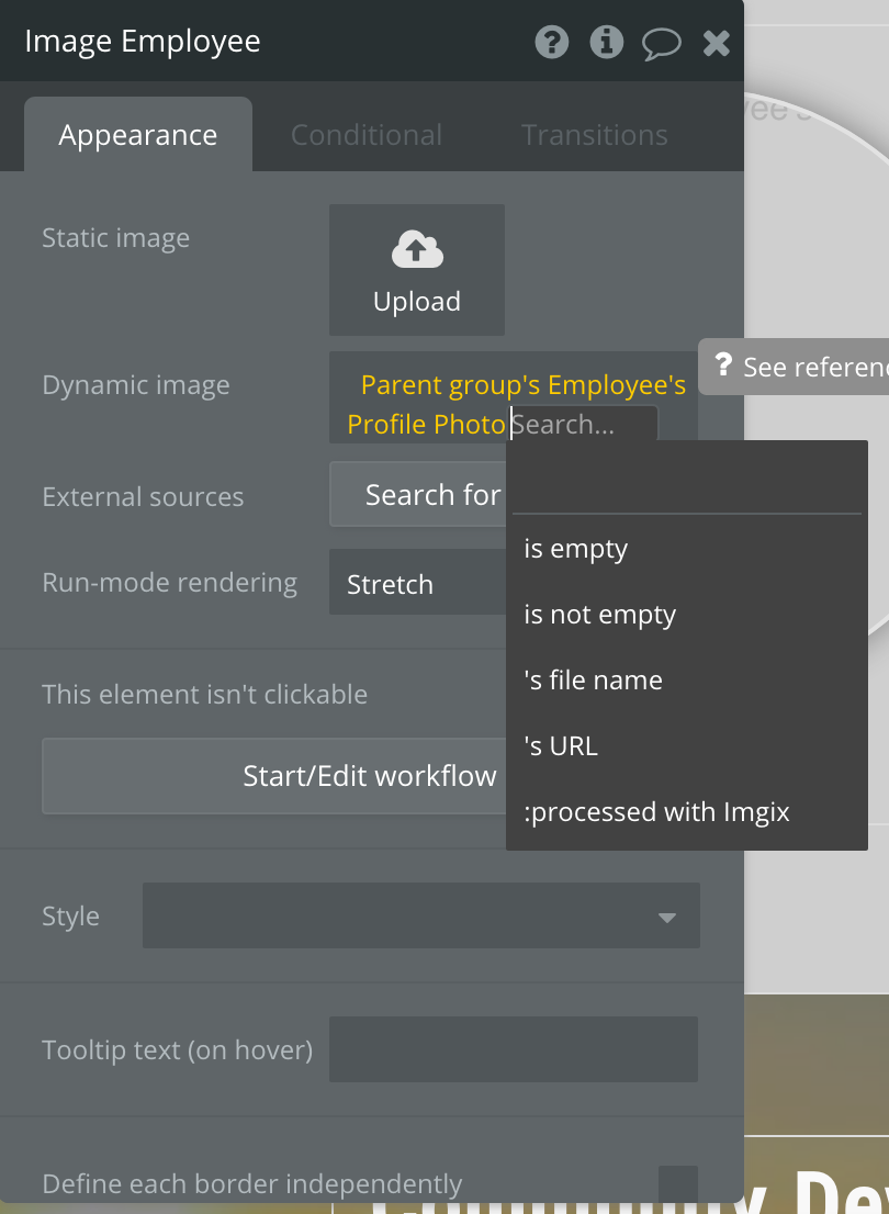

Imgix is built into bubble. No need for any plugin.
Just after inserting dynamic data reference select “More” to open another dynamic data choice box

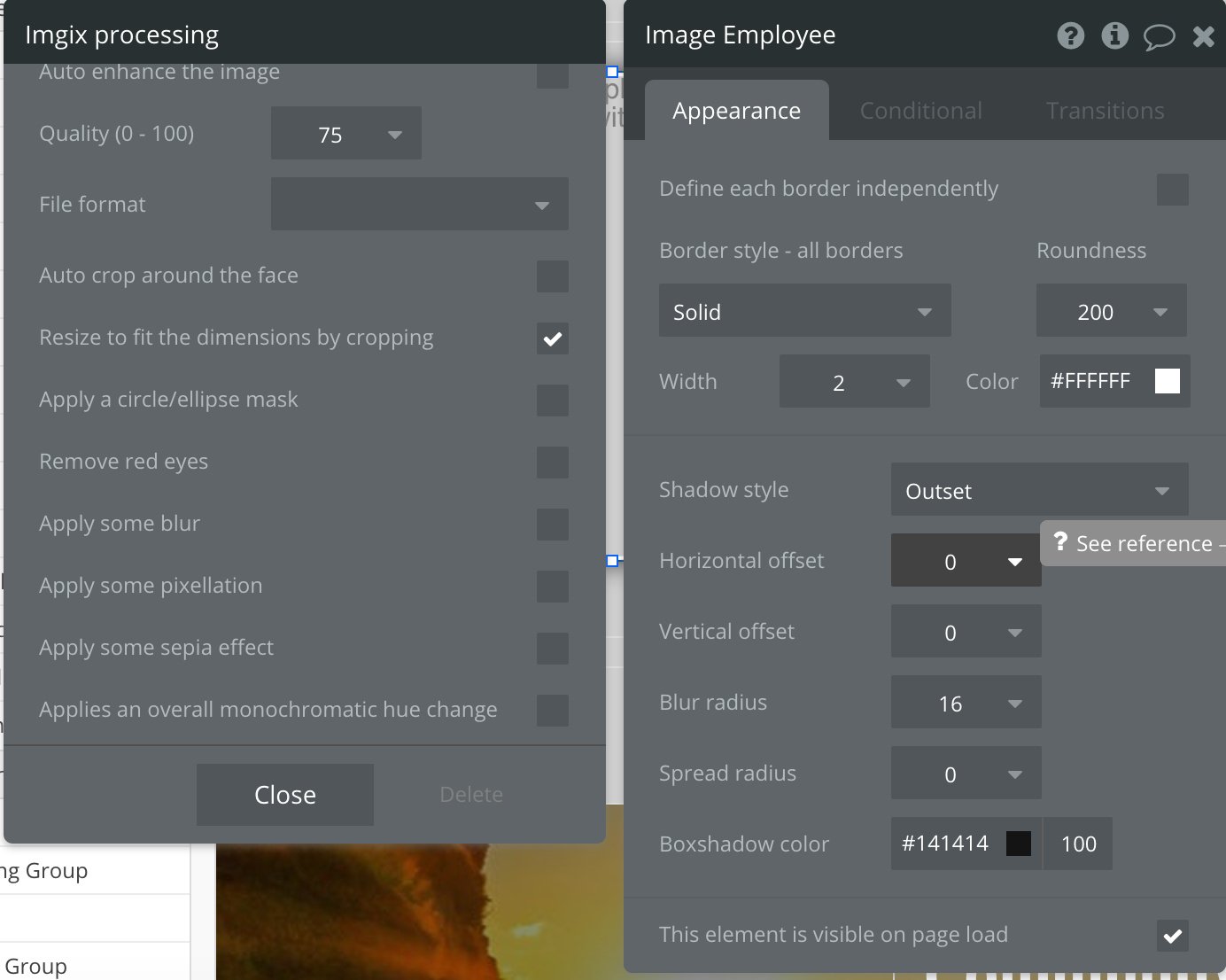

Then when it opens the choices check the box to “Resize to fit dimensions by cropping”
Then you can have your circular photos look right
