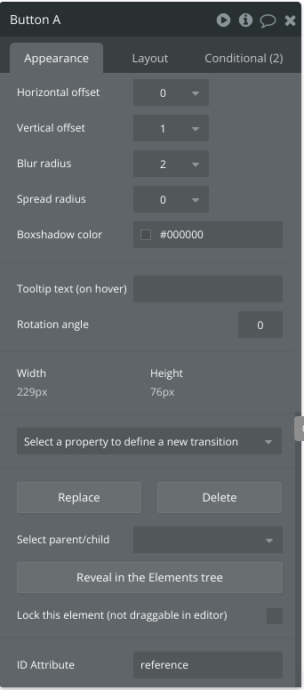

Step 2. Add IDs to the groupfocus and reference element
