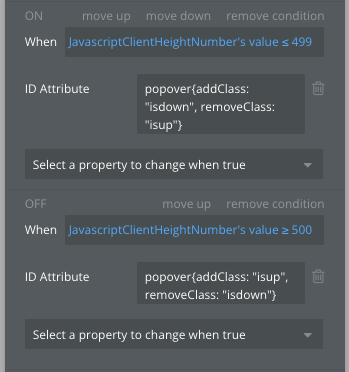

Set a condition on the group focus to read the value of the “javascript to bubble” element and set classes. the class will either set the GF above or below the reference element
Greenshot 2022-08-06 02.03.09

Then use the conditional I already had
Greenshot 2022-08-08 15.01.32
