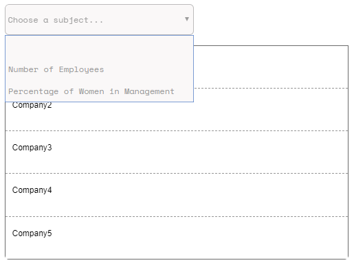

Then I have a simple UI that looks like this…
compare2
… and when an option is selected, a field in the repeating group shows the associated data…
compare3
If that’s what you are trying to accomplish, I did it with a combination of an option set that includes options that correspond to the fields in the db that you want to compare, and then I have a single field in the repeating group that has conditionals on it to show the correct data…
Now, do I have any idea what happens if you try to put 40 conditionals on a field in a repeating group? Nope, I sure don’t. Are there probably other ways to accomplish this? Yup, I’m guessing there are. But this is the one that came to my mind, and I hope it helps, even if it’s just food for thought.
