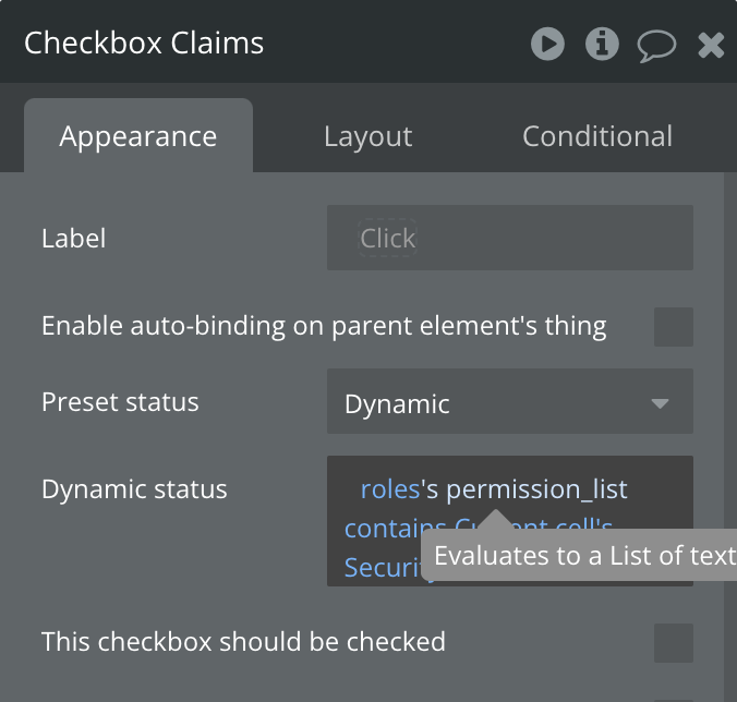

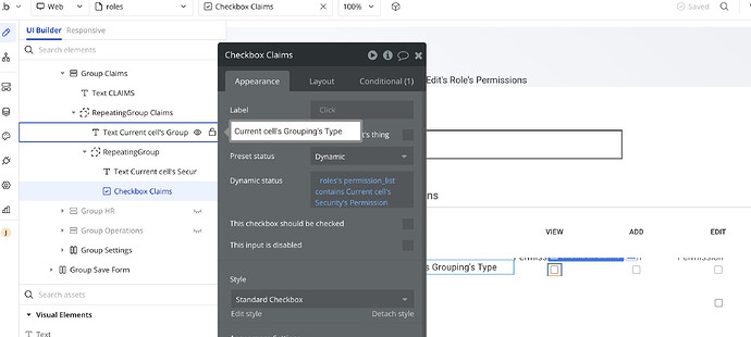

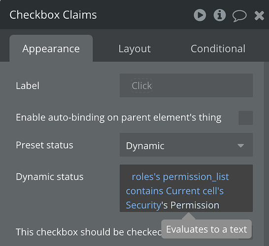

Just for clarity, here is the property window for one of the checkboxes:

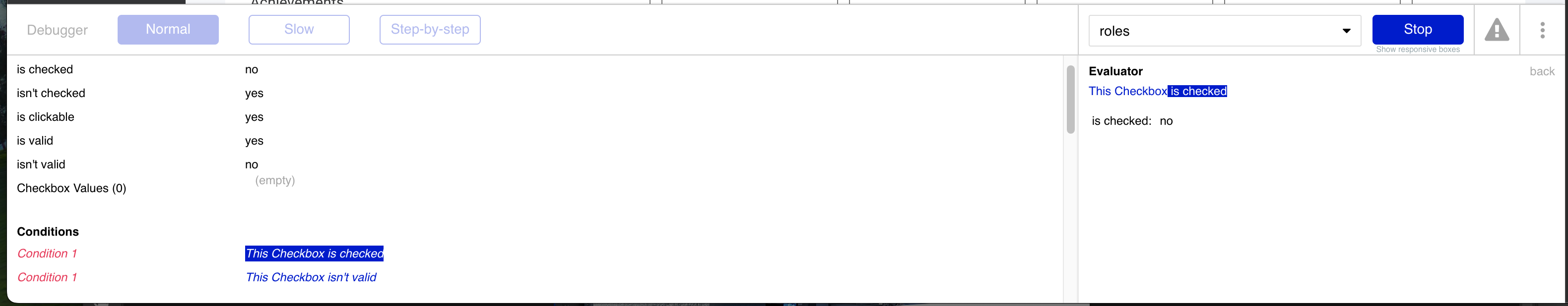

I suggest you have a look at the debugger and see the different elements of that expression and what’s inside them. Check if they match what you expect
I don’t know that they do. I’m not super familiar with the debugger, but selecting the checkbox the debugger says that it is not checked, and it has no value. But I am outputting the roles’s permission_list to the page and also outputting Current cell’s Security’s Permission and the later is definitely within the former.

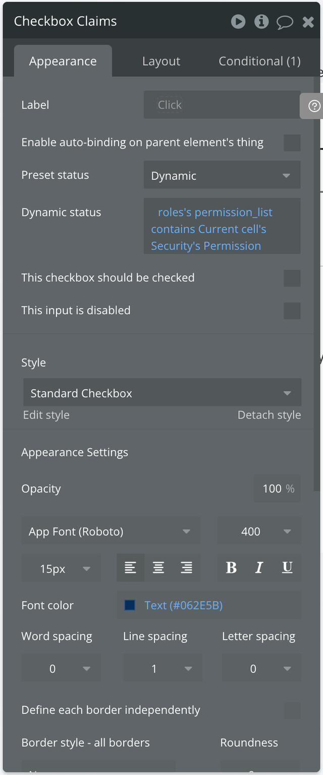

Please share more context
  • Editor view setup of involved elements
  • Editor view seup of the test elements (roles’s permission_list and Current cell’s Security’s Permission)
  • Debugger info of above elements

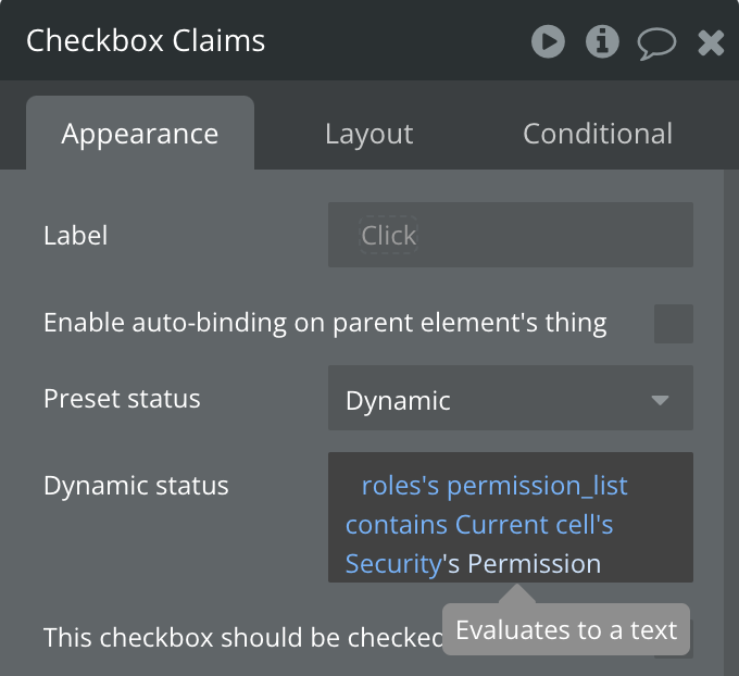

I think it’s probably a little difficult to show all of this. There are a series of checkboxes that are getting outputted in a repeating group:
To troubleshoot, I outputted the state on the page and also in the reusable element, I outputted the value I’m checking against. So both elements of the expression are visible, see:

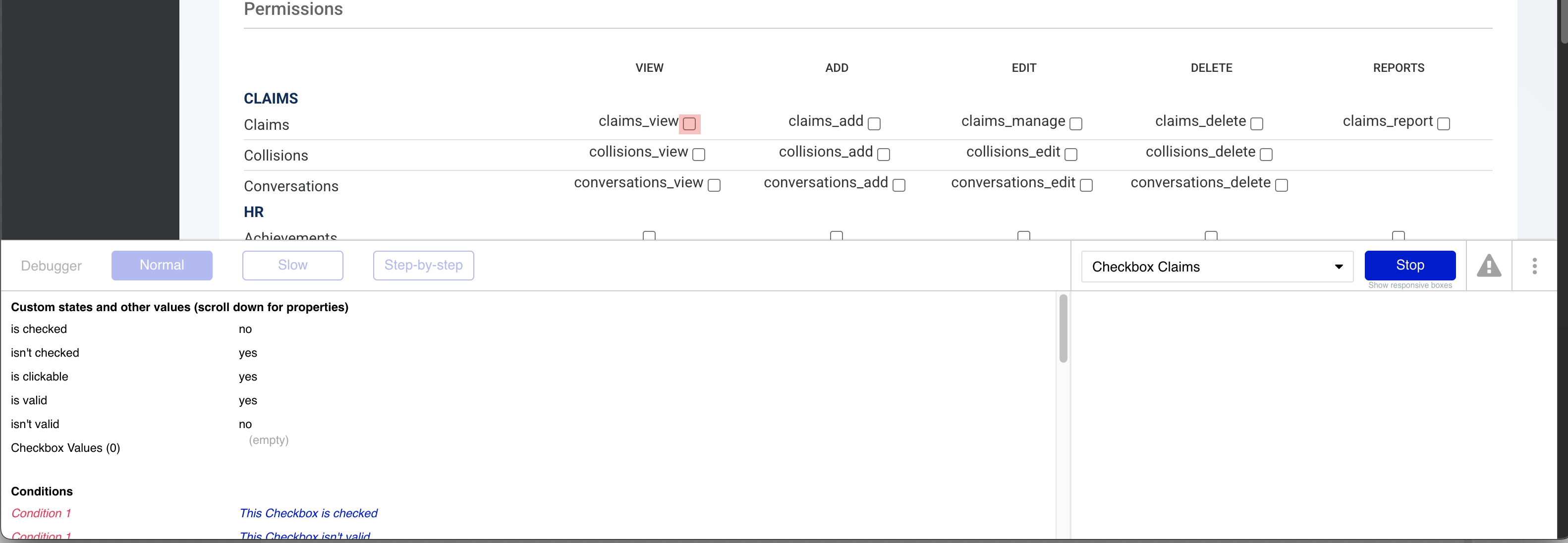

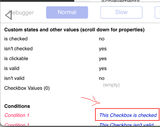

Finally, here is the debugger inspecting the element, which I don’t know tells me much.

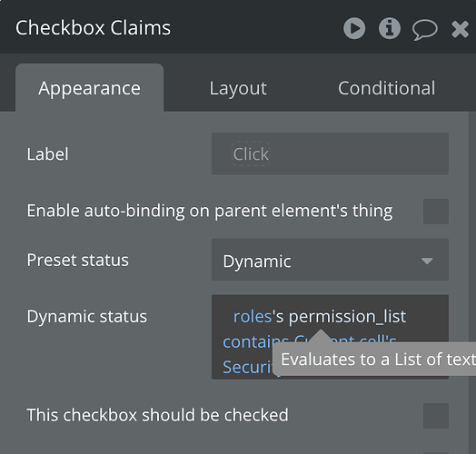

What’s the datatype of elements contained in role's permission_list? I guess it’s Permission?. Is it a datatype or an OptionSet?
Please, in the debugger, click in the source of the value that’s being set for the checkbox and share what’s the output. See below
role's permissions_list is a list of texts coming from a field in a datatype.
Screen shot of Condition 1
What’s Permission?
The error might be in that your are telling Bubble to check if a given Permission is contained in a list of texts, which can never be true as is.
You’ll need to either store Permission objects inside role's permissions_list of extract the text from that Current cell's Security's Permission object.
Also a text. The expression is evaluating whether a text string is within a list of texts… which has been working flawlessly for months:
Could you write that role's permission_list contains Current cell's Security's Permission expression in a Text element inside the RG’s cell and check it with the debugger?
Let’s see why it evaluates to false
Well - that’s super weird. The state has no value by the time it gets to that part of the page. I didn’t even think to check it again after it was already successfully outputting higher up. I’m still not sure what’s going on, but that gives me something to test further. Thank you @ademiguel !
