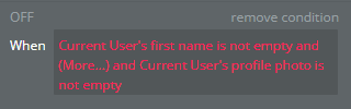

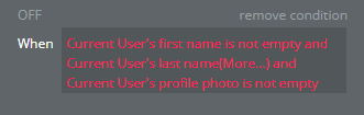

As per your instructions, clicking on each operator with the goal to remove the “Current user’s last name is not empty” condition…
and then finally deleting the “and” following the statement…
As you can see, the final statement is gone.

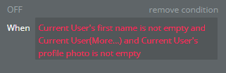

Instead, trying to delete the “and” that preceded the statement…
Again, the final statement is gone.

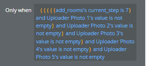

I want to remove the first statement “add_rooms’s current_step is 7”.
As per your suggestion, I start by clicking on the “7” token. Press backspace:
So far so good. I click on the “is” token and press Backspace:
Boom. Entire statement has exploded.
