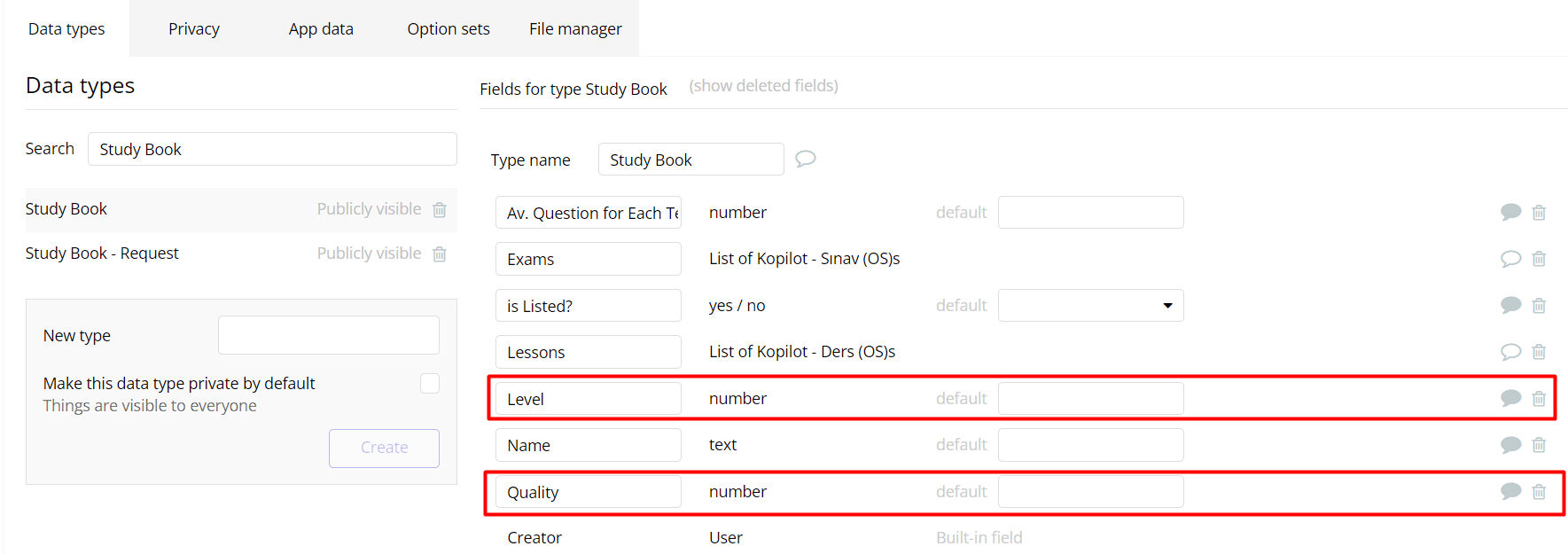

Today, I’ve encountered a strange situation while defining random values to a data field. Here’s the situation:
I have a data type named “Study Book,” which contains several data fields. However, we are interested in two new fields in this case named “Quality” and “Level.” These fields are of the “number” type and must receive decimal values between “0.0” and “5.0.”
For testing purposes, I’ve created a Backend Workflow to assign random “Quality” and “Level” values to approximately 800 data entries in the “Study Book” type using a bulk operation.
There is a Backend WF event named “define-quality-level,” which has a “Book” parameter of the “Study Book” type. This event runs an action with the following flow:
  1. Make changes to Study Book
  2. Define the “Quality” field by converting an “Arbitrary text” to a number. This “Arbitrery text” includes two “Arbitrary text” that has number values seperated by comma in it, then splitted by comma to create list and get random item from them.
  3. Define “Level” field by copying expression of “Quality” field defination.
Then I go to “App Data” and run a bulk operation on all entries in the “Study Book” data type.
Here is the weird part. All data entries’ “Quality” and “Level” values are exactly the same. I expected different random numbers in both data fields. And I don’t understand why these values are copy of each other. Therefore, I decided to share this on the forum to understand how Bubble handles this case.

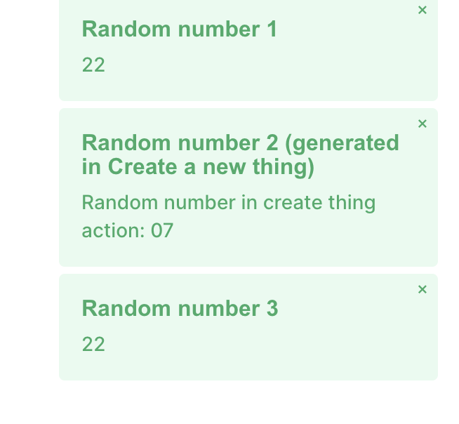

Doing some more (frontend) testing (where all Calculate RandomString expressions are identical:
CleanShot 2024-08-08 at 15.39.44@2x
So, this scenario involving a client side alert and server side Create a new thing appears to generate two strings.
Let’s change it up a little.
In this scenario, we have 3 identical Calculate formula expressions. Two of these are on client side alert actions, and one of these involves the server (Create a new thing). The two client side alert actions share the randomly generated string, yet the Create a new thing’s number is a different randomly generated number.
And if I add another server-side action:
So, it seems that server side actions will generate a new random string each time, whilst client side actions will share the same random string. In the above screenshot, 1 and 3 are client side alerts, and 2 and 4 are Create a new thing.

Can you try on my app and send a screenshot of the alerts you see? This is what I get, same result with debug mode on and off (in case that made a difference). Same client side random string, different create a new thing random string
