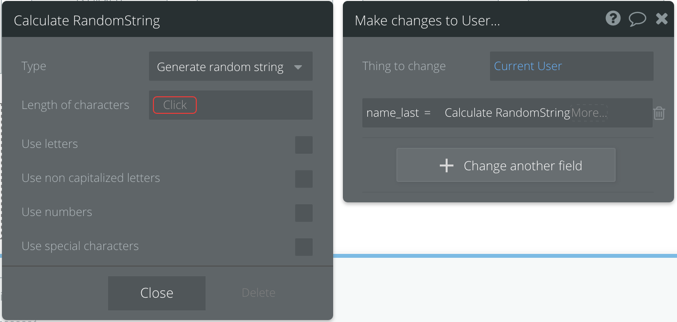

Unfortunately, the 2nd part regarding the sequential ID numbers isn’t working so well. I tried to do a search for customer id’s (the name of the field to modify) to yield the ‘max’. Then added +1 as you described. I have another user as the ‘anchor’ at 999, so the next user should be 1,000. However, it just ends up being 1. Here are screens of the set up below:
I tried with ‘last item’ as described on this post as well, still no luck. Same result.
Hmm, I get it to work with your argument.
with both :last item and :max. Could you run through it again to see what’s up? I thought it had something to do with your thing to change but also works for me. I don’t know what your workflows look like before this one though.
It’s not a refresh DB issue?
oh wow. I don’t know. I’ll have to play with it a bit more.
I know that I had data imported with different customer IDs. that field I set to ‘text’. But I created another field (the one in the screenshot) which is set as a number. so that is not it. And I can’t see how it is a DB refresh issue since the ‘+1’ was added, but the ‘search for’ didn’t yield any result. thus the ‘1’.
I noticed that yours was called ‘customer IDnumber’ That shouldn’t matter as I am sure that is just how you labeled the field…
hmmm… I’ll have to play around a bit more.
thank you!
This is possible, if for example you recently added the field, or manually edited the “999” it wouldn’t have given the UI’s cached database values a reason to update.
Incrementing the max ID is a vulnerable method; when two users are created at roughly the same time they might return the same max ID, and caching makes the window of error even larger.
