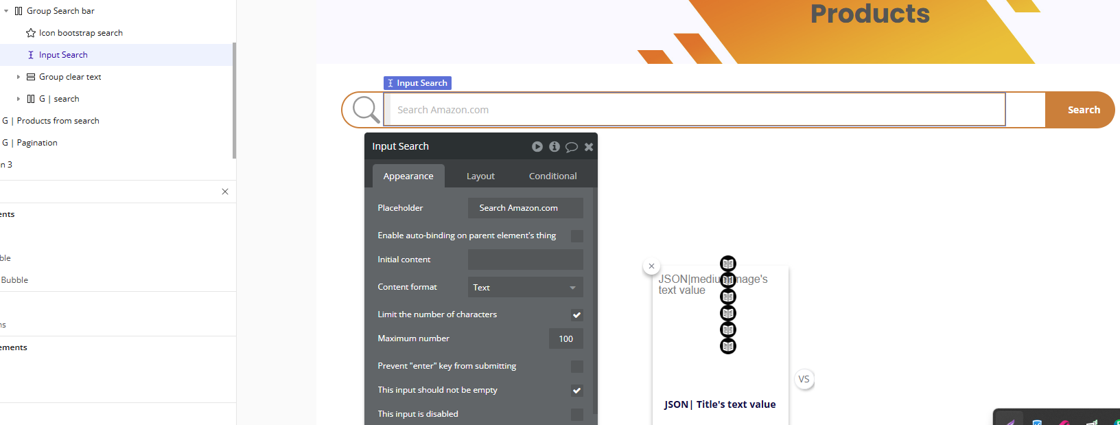

Enter key dosent triget custom event
I have the same mechanism in both pages, but one doesn’t work.
I’ll appreciate any advice.
I’m expecting that pressing the Enter key will trigger the customer event.
Both the input field and the group/button are in the same group.
The Enter key is allowed for submitting.
Custom event:
Input elements:
Button elements:

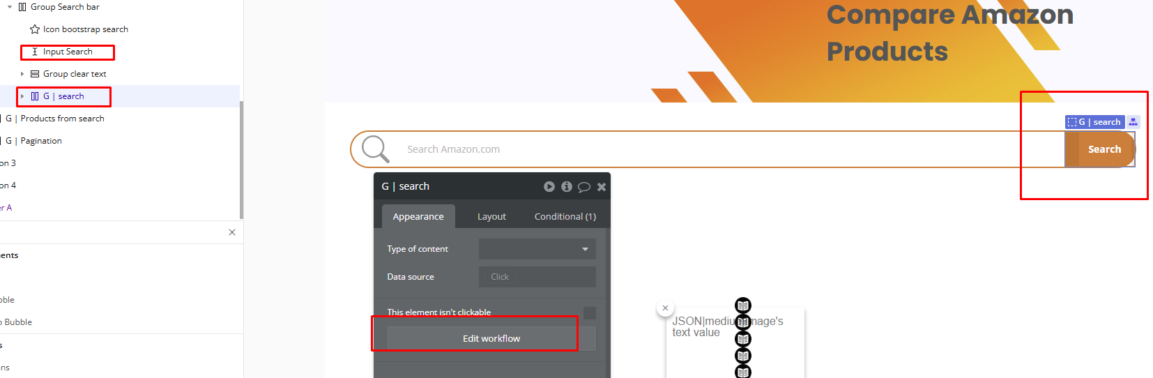

For pressing Enter button to work you MUST place both an Input and a Button inside the same group, and link the Enter action to the Button.
Your setup isn’t working because you are actioning from a Group, i.e. the Enter action is executed when clicking a Group, not a Button. Change this and you’ll get it.
Thanks for the input. I have an identical setup on another page using a group instead of a button, and it works there. I tried your suggestion, but it still doesn’t work. Perhaps it’s a bug.

The unexpected behavior you were seeing was due to the Input Search element having the “This input should not be empty” property enabled. When this setting is checked, Bubble will prevent any workflow—including custom event from running if the input’s value is empty at the time the workflow is triggered.
