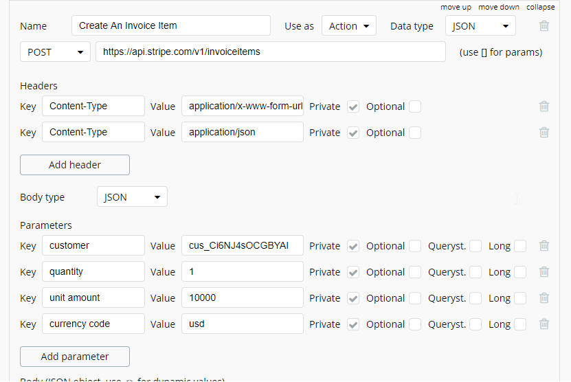

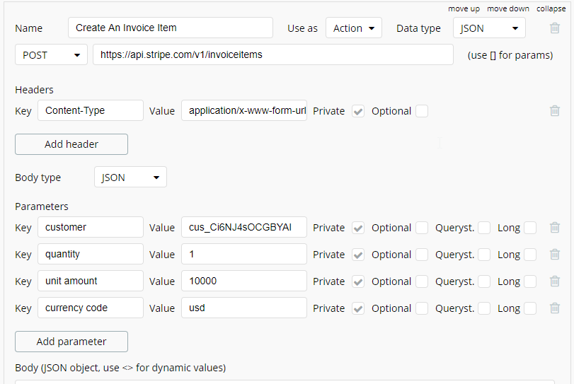

This error really bugging me.
Trying to figure out why I’m getting the below Content-Type error with my setup appearing to be correct:
First thing, you need to create a json payload. Actually you have set parameters.
Also, you may need to add header
Content-Type: application/json
NEvermind. I forget that Stripe use form encoded. Not json.
Add header Content-Type: application/x-www-form-urlencoded
If this doesn’T work, I have another post that state what currently happen in different case with the API Connector. Bubble need to have a check and fix that becayse it’s very weird. I will try to find it
