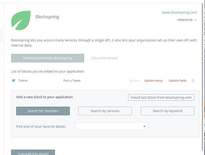

The Bubble part is pretty easy. The Twitter part is a little more challenging. You will need to set up a twitter app (here is a link). You will generate the api keys there that you will need to configure the blockspring plugin.
Install the plugin. Here is a screen shot of my blockspring plugin:

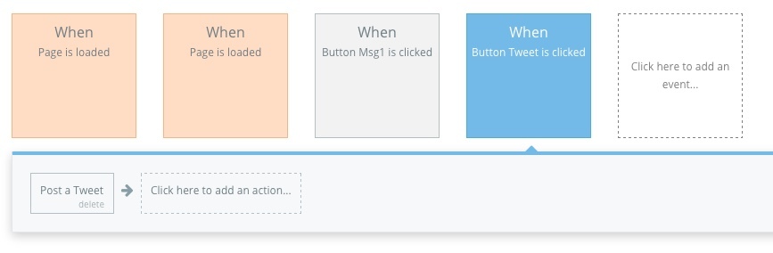

And then I set up this workflow for the “Tweet button”:
