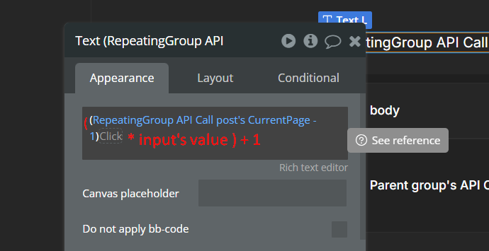

Hi! I want to get the result of a calculation (number) with this formula:
( ( Value from Custom State - 1 ) * Value of input field ) + 1
That is a seemingly simple math expression with brackets, but I don’t understand how to solve this with “variable” queries (custom state and input field are also in number format)
As you can see from the screenshot, I’m stuck on forming the first expression with brackets… Then I can’t add something else after the closing bracket (there is a multiplication sign “*”, but as a result it is perceived as a text character, not as an operator) Can someone help me, suggest me, maybe I’m doing something wrong?
You have to pick the math operands (+ - * /) from the drop-down list or they will be perceived as text. You have to type or use drop-downs in each Click field from left to right or you confuse the Bubble editor. Somehow, you skipped over a “Click” field and kept typing.
Or I might not understand you correctly. With dynamic fields like this, sometimes we have to delete everything and try two or three more times from scratch before things will finally fall into place.
How do I display these operators in a drop-down list? How can i find them? I even just click on the Click button, but I can’t find the math operators…
Although at first I was able to find a math operator (the first screen shows “…-1”, but as soon as I put the expression in brackets, I can’t add another math operator after the brackets.

Apparently you are free typing the parenthesis instead use the option that allow expressions create them automatically based on how you write the expression.
So, turn on the Experimental Parenthesis feature (Experimental for years now). You can do this at Settings > Versions tab.
Oh my God! You just opened my eyes! This is what I needed, I created a new project in a new account for my client and completely forgot about this experimental feature! :rofl: I’m sitting here wondering why brackets don’t work - they worked before (in another account)? Thank you, you’ve shown me the right way in time!
