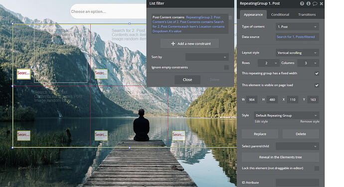

I have users who can create 1 post containing multiple data such as images, and locations attached to those image. I am having issues trying to figure out how posts can be filtered based on posts containing a location within the dropdown. I have generated a repeating group which displays 1 random photo from a post, and when that photo is clicked, a pop appears showing the rest of the data for the user. However I am struggling to get the dropdown filter to work. I need the repeating group to display only posts containing the dropdown value. As seen in the example images, there are posts which include photos in USA, however when this option is picked in the dropdown, posts inlcuding photos in USA do not display?
Unfortunately still having issues with this. I have attached more screenshots of the options I get, and I keep trying various scenarios with no success.

Even if this would work, I would recommend to save the Country as a text separately in a field on your Post data type.
This way you can use it inside a search and searching for posts becomes more efficient instead of using a filter (Adv. Filter can be painfully slow once you have a few posts).

@jukoen I have managed to extract the country as text in a new data field. However, when trying out options for filtering the repeating group, it doesn’t give options directly to enable ‘dropdown value = country’ for example. The country is located within the ‘post content’ section, which then requires further data sources, instead of doing an ‘=’ to dropdown value.
The aim is create 1 post with multiple data, such as images, and locations attached to each image. This is the way I have been able to build it, by having 2 different data types, but linked with each other.
Post 1 is a Trip
Post 2 is a Post like I described it
If you want to show the Trips that have Posts from a certain country in it, then simply save the countries as a list of texts on the Trip data type.
Then in your RG search you can access the Trips where countries contains ‘Dropdown’s value’.
Unfortuantely, the way you have built it originally will start to get pretty slow as soon as you have a few Trips listed. I understand that as a beginner it is not that straight forward to build these searches in Bubble but I think you should be able to get it done now.

@alendedja79 I think you are very close to achieving what you want!
I think it makes sense to rename your tables like this:
Then have Trip hold the countries as a list of texts in a new field to filter on that in a search.
Any additional field you’d like to filter on should also be on the Trip datatype ideally.
I am saying ideally as having nested filters of course works as well, but is going to slow down your app immensily once you have say 10 Trips with a few 100 Posts.
So leave everything as is just make sure you have the fields you want to use in your search/filtering logic on the Trip data type.
