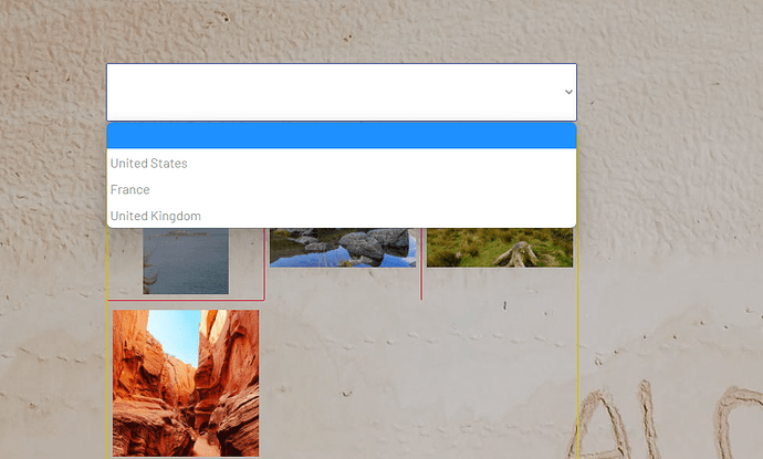

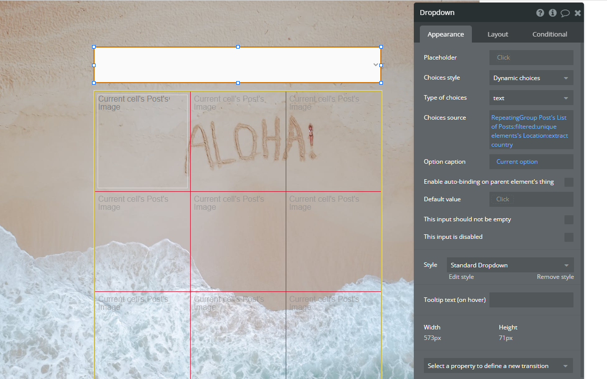

I am trying to get a dropdown filter working based on country of the photo taken. I have chosen dynamic choices for the dropdown extracting the country for each post photo, and it is showing on the viewing page. The issue I am having is that the repeating group which includes the post photos, is not filtering the posts based on the country chosen in the dropdown.

Thanks for the suggestion, however there are still issues. It is location based, so when trying to add a constraint country doesn’t appear. Only ‘location’ appears but then requires many different variables?

On the repeating group do a search for photos, no constraints need to be added there. Then at the end of the search click More and select filter. Then there in the constraint select Advanced. Then you can say This photos location extract country is Dropdowns value.

Make the default Data Source ‘Do a search for’ without the filter. Then on the Conditionals put When ‘Dropdown’s value is not empty’ and edit the Data Source to apply the filter there.
