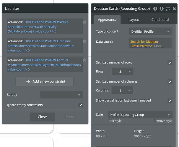

I am using three filters (specialty, state, payment) for a repeating group on my explore page. The filters work properly, however I need help with three things.
(1) Before a user selects the applicable filters, I would like all of the profiles in the repeating group to show. Right now, no profiles show until the user selects the applicable filters.
(2) I would like the repeating group to update when at least one filter is selected by the user. Right now, no profiles are visible unless the user selects an entry from each of the three filters.
(3) If the user selects the applicable filters and no profiles come up, I would like certain text to show. I think I need to use a conditional to show the element, but I’m not sure how I should write the conditional.
Any help would be appreciated.

Thanks so much for taking the time to right this helpful response Nino. I just implemented #3. Now I’m working on #1 and then will check out the video you suggested for #2.
For #1, it sounds like the conditional needs to go on the repeating group element. Do you mind writing out the condition using Bubble’s language? I understand what you’re saying in theory, just not sure how I write it. Thank you.
It is not a condition but rather a data source for the repeating group. You can use it here like you how you usually do it
Simply search for dietitian without any constraints
Okay that makes sense, but then I can’t do an advanced search using filters like I have it set up now correct? Right now I’m using the advanced search to filter the data by those three criteria.
yes you would not need to do that anymore especially since you should be doing what I suggested at #2 for optimal performance
But if you were to not do #2, you could still achieve that by again, search for all of the dietitian at first but now, you could have a “do when” workflows where if the inputs are changed , change the source of the RG
Okay thank you. I’m working through the video now. Sorry if this question is dense, but it looks like when he sets up the data source he used a few constraints. Do I need to have these constraints to start with? Would it be sufficient to just have the data source as “Search for Dietitian Profile”. I’m not sure what the constraints he added are doing.

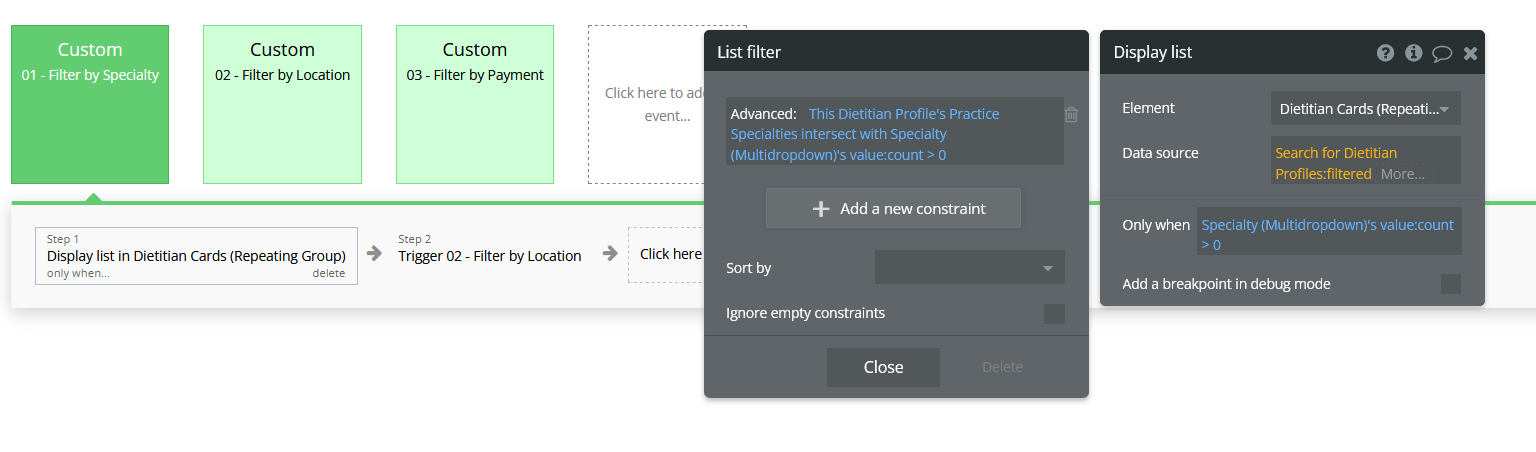

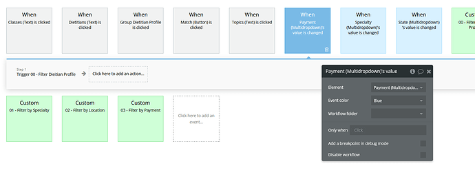

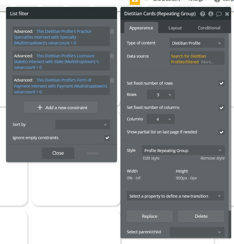

I went ahead and tried daisy chain filtering as it was explained in the video. In the first image you can see that when one of the three dropdown values are changed, the custom filters are triggered. This seems to be working correctly.
Where I’m running into trouble is with the results that are shown. I’m trying to set it up, so that a user can do this search “Specialty X OR Specialty Y” & “State A or State B” & “Payment A or Payment B”. Right now the individual searches for the different parameters work, but not the “ands” combining the filters. I’m guessing the issue is with my filters in the custom events. Any chance you can help me figure out how to write this? Each of these filters is a multidropdown.
