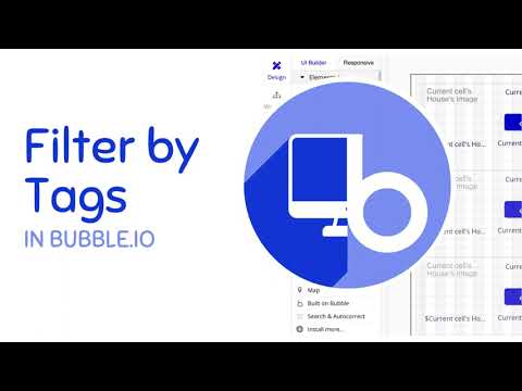

I think this video solves your problem. Start at around 3:30:
Just add two of the conditions that the video suggests, one for the first dropdown and the other for the second. That should work.
