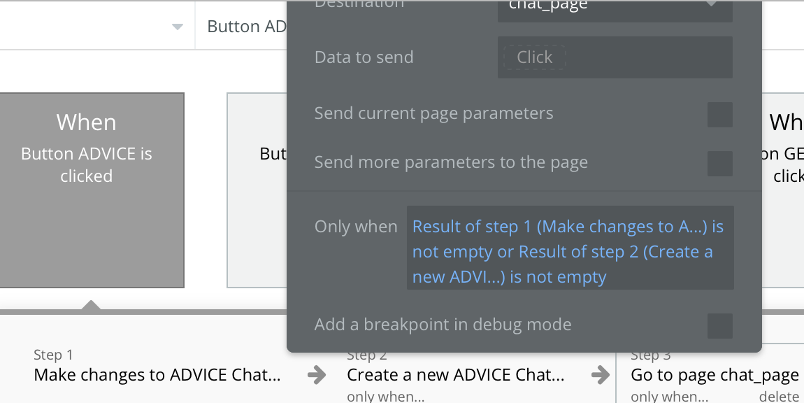

Hey mike, thank you so much. This was very helpful. I know that I was helped before, but I was still confused and in my experience I don’t get replies back when following up on a thread.
About your solution, where should I be navigating the user to the chat room? In the + change/set another field section?
Not knowing what “navigating the user to the chat room” actually means in your app, the Go to page… workflow action comes to mind. So, there is probably a third step in the workflow that sends the user wherever they need to go in order to participate in the chat.
Hey Mike, yeah the Go to page option sounds right. My problem is do I just send the user data? Also, I only send them to the page if step 1 or step 2 (that you talked about before) are not empty (that way one of them is true).
Well, once they enter that workflow, one of those conditions is always going to be true, so you shouldn’t need the Only when condition you are showing. I think you might need two Go to page… actions. The first one would have the Data to send as the result of step 1 only when the result of step 1 is not empty, and the second one would use the result of step 2 in both of those places.
The data to send would be the result of step 1’s chat users? I can’t only put result of step 1 for the data to send.
You only need to put result of step 1 (or result of step 2 in the second Go to page… action) because the result is the chat itself, and the chat “knows” which users are in it.
I’m getting this message when doing that though:
