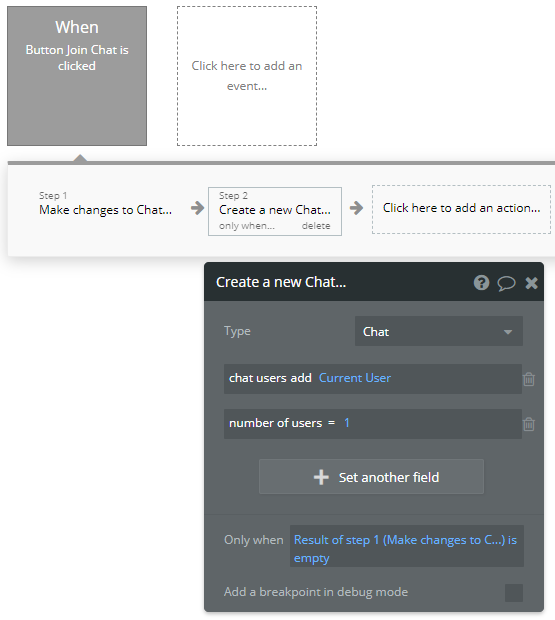

That being said, here is what I would do if I were you. I would add a field with a type of number to your Chat data type, and I would use that field to store the number of users in the chat. Why, you ask? Because if you don’t have that field, I believe you are going to have to use an advanced filter to find a random chat with one user in it, and you don’t want to do that because the filtering will happen on the client side and it will likely be pretty slow.
So, I would add that field, and then I would set up a workflow with the following steps…
I tested it out, and it does exactly what you have described. Oh, and about 1-on-1 help, @J805 offered that to you in another thread, so there you go.
